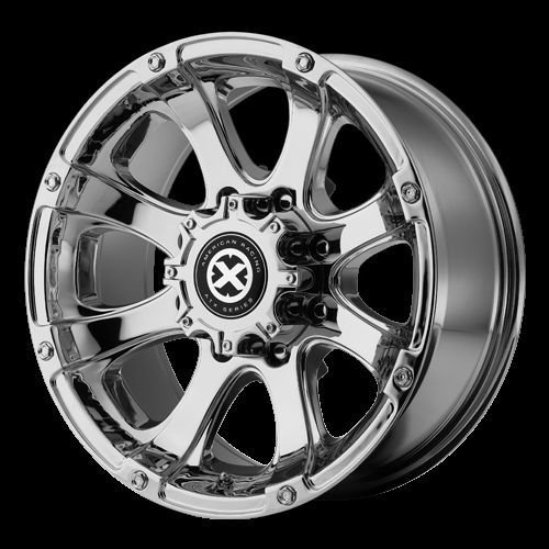

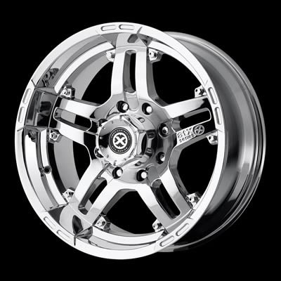

    I know there is a thread but will these fit the Taco. The first is a 17x8 4.5 backspacing "0" offset. Wouldn't you want some offset? And the second one is a 17x9 with 4.53 backspacing and " -12 " offset. Which one would fit better after I install the Eibachs and 5100's

    They are basically identical specs, except one is wider. Both would work.
