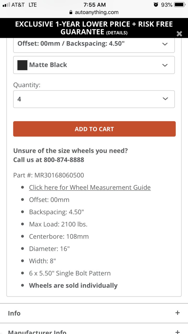

    Hey guess I’m a little unsure when ordering wheels so I was wondering if someone could help me and tell me if these wheels will work for my 2018 Tacoma trd off road, with stock suspension. If not what exact demensions do I need and will they fit weather I do a 2in leveling kit or a 3in lift also. Thanks guys

    How about a picture of the wheels you are thinking of. Our bolt pattern is 6x5.5.
    Wheel size doesn’t determine what tire will fit.

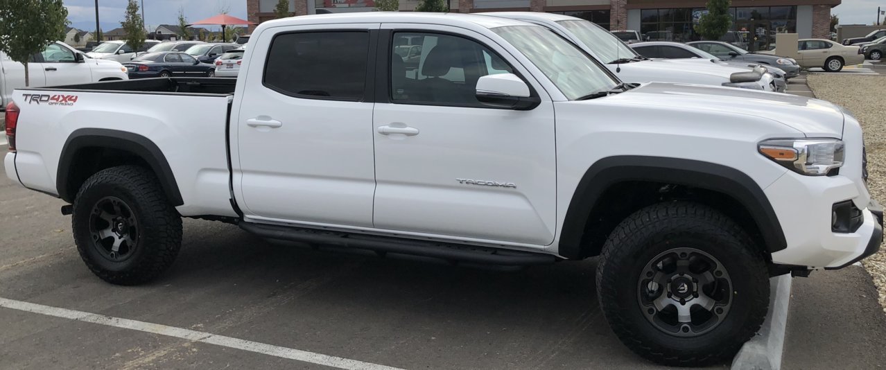

    Here’s a pic of my truck with stock suspension and wheels with those same specs. Running 265 75 16 tires without rub.

    Lift will not impact whether or not a wheel fits. With those measurements they will likely fit. However, it depens on the shape of the wheel and thickness of the wheel itself. It also depends on what tire size you plan to run, different dimensions than stock can cause tires that would fit on stock wheels to rub
