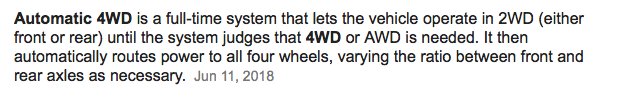

    I'm not a Chevy fan, but I understand they have 4low, 4hi & 4auto. That would be a nice option...
