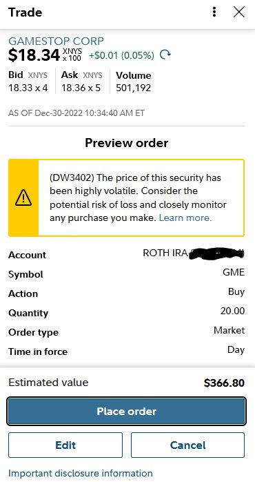

    This did fill today...had to dip my toe...
