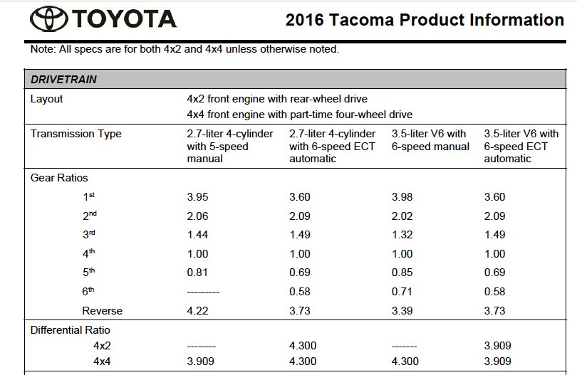

    5th-6th gears are over-drives, 4th gear is one to one I believe that latter ratio was used as over-drive long ago so it is still tall to cruise at 70+ going on prolong climbs, your engine will scream but its design is not like your old truck engines, this baby was born to rev high, so no worries.
    Moreover, I can’t see how software will overcome it for a very long climb. Using ETC may help so I’d use that, S5 too and tough it out because unless we get another gear or two, we maybe SOL under your type hills.
