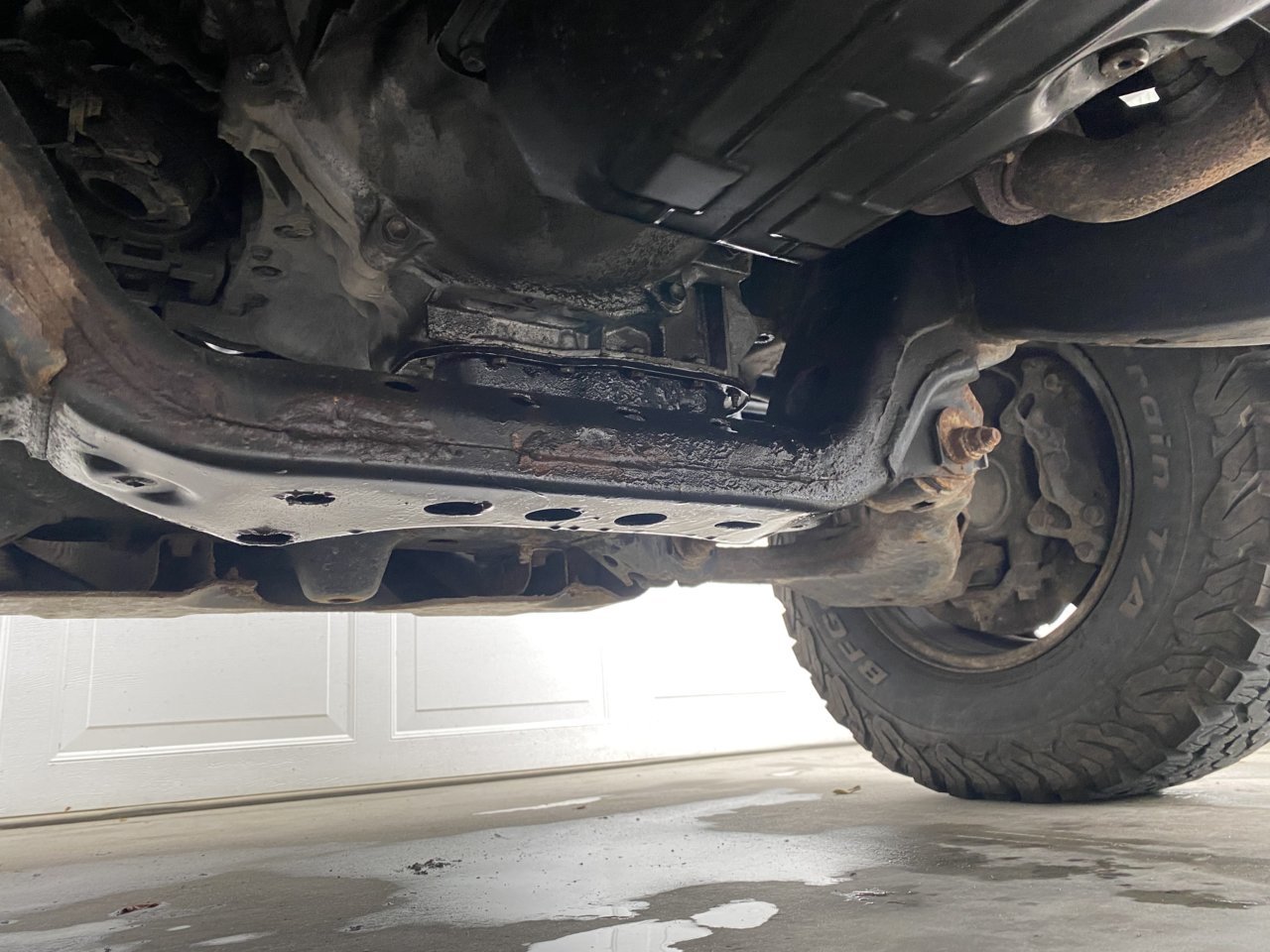

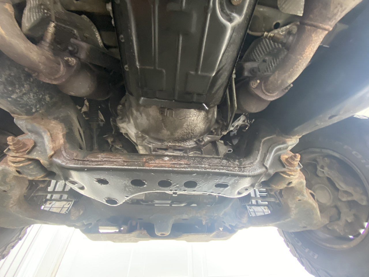

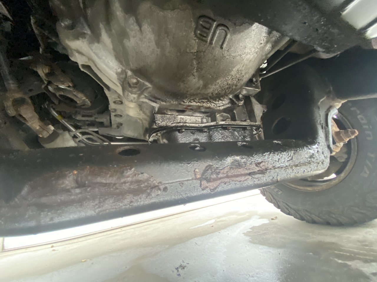

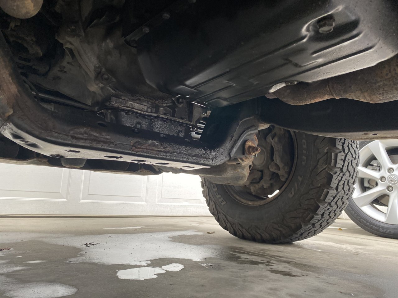

    Hey all, recently started seeing a lot of leaking under my car parked in the driveway. Looked to be engine oil but i took it in and was told it was leaking oil from the front oil pump seal and/ or bushing and that I should replace the tranny altogether. Any input is appreciated thank you !!

    probably just needs a seal replaced. If you're not experiencing any goofy shift patterns, I'd guess that the tranny is just fine.

    If the trans if shifting fine and has been maintained properly there is no need to replace it. Clean up EVERYTHING with degreaser so you can see where the leak is coming from. Pay attention to the transmission OUTPUT where the driveshaft goes into the trans, on a prerunner those seals are known to leak over time and could be your source (and is WAY easier to change vs a rear main seal on the motor / input seal on the trans)

    Yes it shifts fine, also this tacoma is 2012 4 cyl prerunner with 78k miles. Although this is the first time I’ve gotten the transmission fluid changed or even serviced in 40k miles.. I could’ve just screwed myself… only engine oil change
