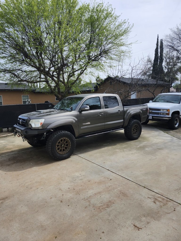

  11. Jun 12, 2025 at 7:53 PM
    Mully
    Mully Well-Known Member
    Feb 12, 2014
    #122907
    5,269
    CA
    12 DC 4x4 Lifted Sport
    Lifted, Kings, Locked, 295s and more.
    Never, 2.5 to 3 inch lift.
    Over 70K miles with no problems at all.
    Good luck with your truck.
