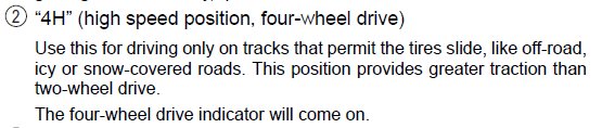

    This is what my manual says.
    There's a reason why you only use it on tracks that permit the tire to slide. The fronts have to turn faster than the rears of you can't steer.

    When cornering, the outside tires must turn fast than the inside tires and that is the reason 4WD use should be limited to terrain which allows tire slippage.
    Not because the front tires turn at a different speed than the rear while in 4WD.
    Go prove it to yourself if you don't believe me.....here's a very easy test for you to perform.
    Go drive your truck in a straight line on the highway at 50 mph and engage 4wd high. Notice any tire squealing? Sliding? Chirping? Loss of control resulting in a rollover crash?
    No? That's because your front and rear axles are turning at the same speed!
