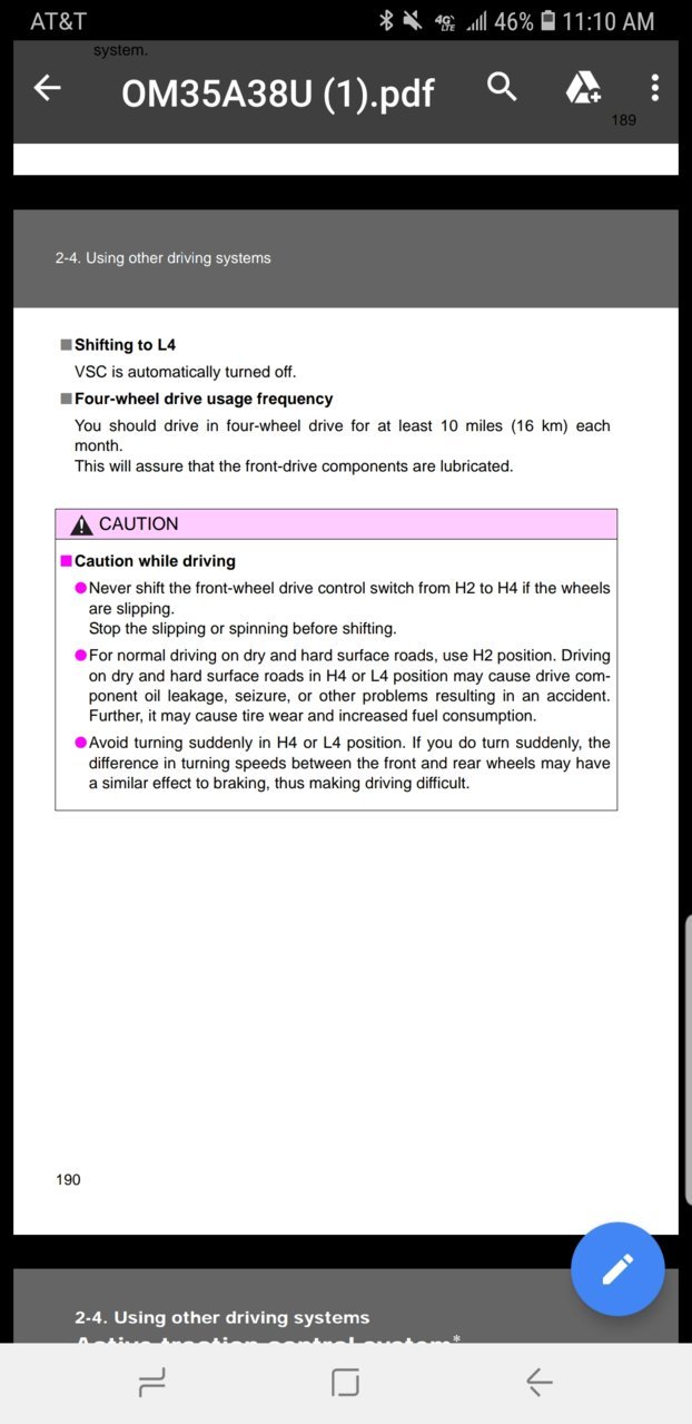

    Sorry reviving a dead post but, just a little confused here. I want to test my 4x4 and I only have paved roads where I'm at (although I can drive 3 hours to my ranch and test on dirt/gravel if that's necessary for a test) and while the manual does say to drive it 10 miles in four wheel drive every month, it does give a caution about driving on dry/hard surfaces so... Should I just wait till I get time to go to my ranch?

    It says 10miles because some people will never use it then when they need it, everything is seized up. They just say to use it so they can protect themselves and if you come in with problems and say you never used it then they have you to blame.
    It says nothing about using 4lo and keeping the transfercase lubricated as well, only the front end which to me isn't right. Both need to be used I've heard stories and know one person who had their tcase fail and only have 2hi and 4hi, it could not switch to 4lo as the selector fork or something was seized.
    Do you need to use it 10miles each month? Probably not, but if you never use it then ya might be a good idea.
    I personally don't do it every month because I likely get more than that in each month in the summer from trail use, and in the winter I get it as well. There's maybe 3 months of the year I don't use/need 4x4 and in those months I really do not use it to make sure its ok as I know it gets used and lubricated more than enough with all my usage at different times.
    Some guys on here say they use 4hi on the highway since its relatively straight and an easy way to get in your distance quick.
    I love how they basically give themselves a way out either way.
    Oh it stopped working? did you ever use it? oh you haven't? well then its your problem.
    or oh you used it on dry pavement now its binded up or broken? well its your problem then.
    and if you say you used it off road they'll pull some shit that it voids warrnaty so again its your fault.
