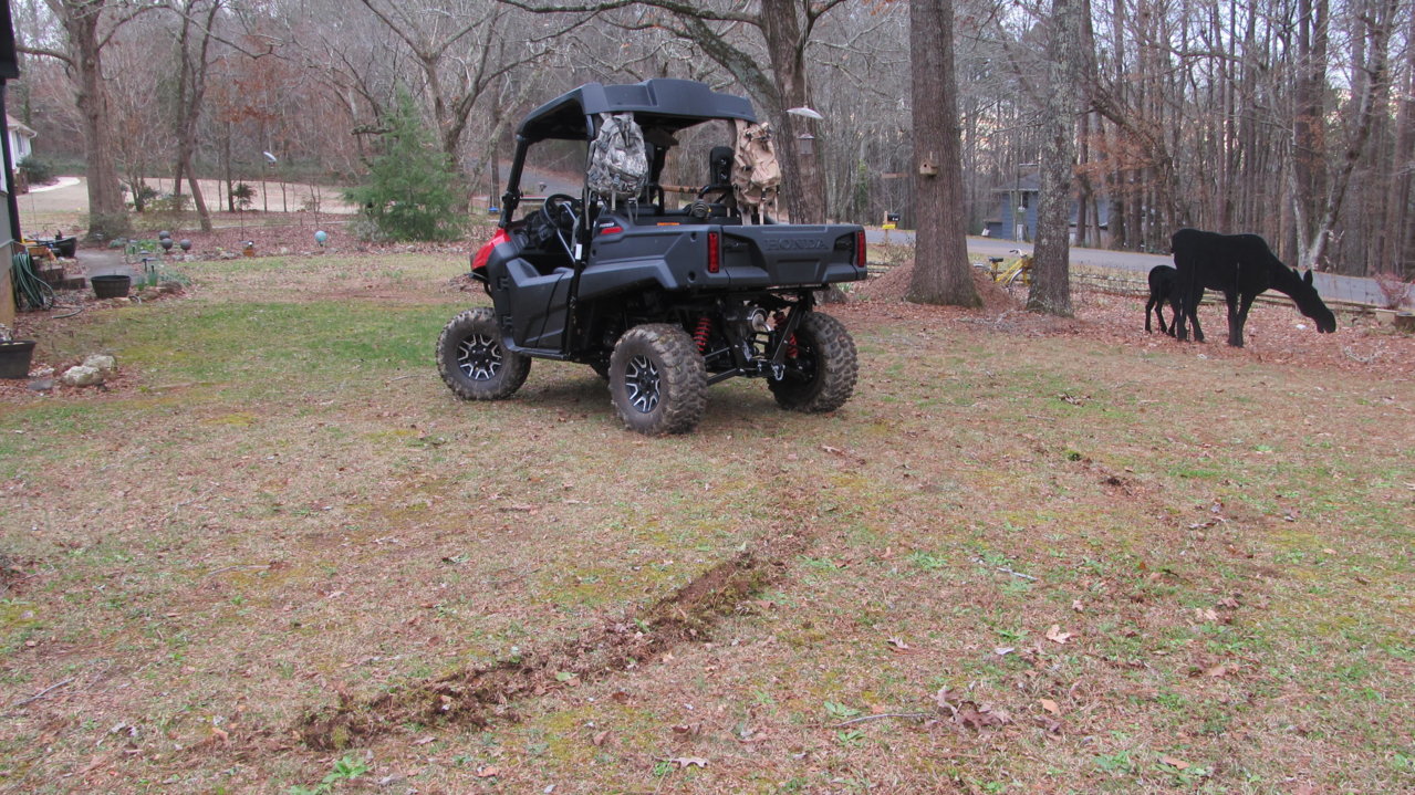

    I was driving my ATV in my yard a few weeks ago and had a good chance to illustrate what is happening. When you go around a corner each of the 4 wheels takes a different path. The inside front wheel has the least distance to travel, the outside rear wheel the most. When operating in 2wd each wheel can turn at different speeds to account for this. When in 4X4 the transfer case locks the front and rear axles together and it tries to force all 4 wheels to turn at the same speed. But for this to happen the inside wheels MUST spin and slip some on the ground since they are now turning at the same speed but have much less distance to travel.
    As long as you're on a surface that will allow the wheels to slip some it doesn't do any damage. But on pavement, or even off road in high traction areas it really puts the drivetrain in a bind. You COULD have a catastrophic failure of your transfer case or other parts of your drivetrain. But that would be rare. Even if it doesn't fail immediately, you are overstressing components and that will lead to premature parts failure.
    You can see how much both of the wheels slipped on inside. The outside front wheel spun slightly. The only wheel that didn't spin during this turn was the outside rear. This was a 1200 lb vehicle on wet ground. Imagine how much stress you're putting on a 4000 lb truck on dry pavement.
