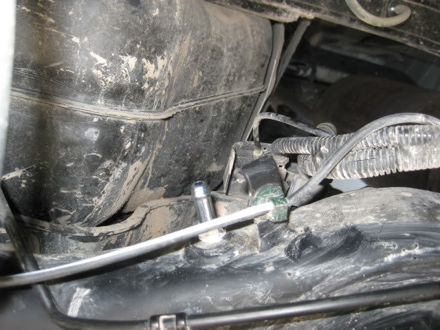

    Olson, some of the photos posted above are from my thread on doing the mod... I recommend you click the link to my thread (below in my sig.)... See it all... http://www.tacomaworld.com/forum/technical-chat/111954-my-differential-breather-mod-photos.html
    I opt for easy, and this mod was easy. The water gets in through the AXLE seals, not the stock breather on top of the diff. By changing the one way breather (lets hot gasses out only) to a 2 way (true) breather up higher, it breaks any vacuum created inside the diff., which is what causes water to suck into the diff. when you drive into a foot or more of water (whatever your axle to ground distance is).
    The 2 way breather we use, is the same one that is on the front diff. at the end of a tube... Seriously, the Off Road TRDs (or perhaps all 4WD Tacos) should have the same set up on the back, as it does on the front!
