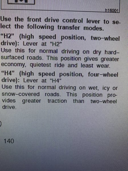

    Someone for the love of god get your owners manual and look this shit up. It comes with the truck for a reason :rolleyes:

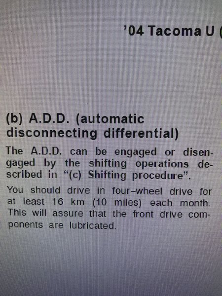

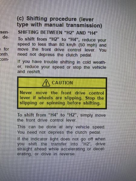

    Here does this help!? Sheesh

    No, but generally speaking if you're in conditions that warrant the use of 4wd then you probably shouldn't be going very fast anyway...
    To engage 4hi you should be going under 55(?) I might be off a little on that one.
    To engage 4lo you want to be at a complete stop and in neutral (or clutch in if you're manual).
