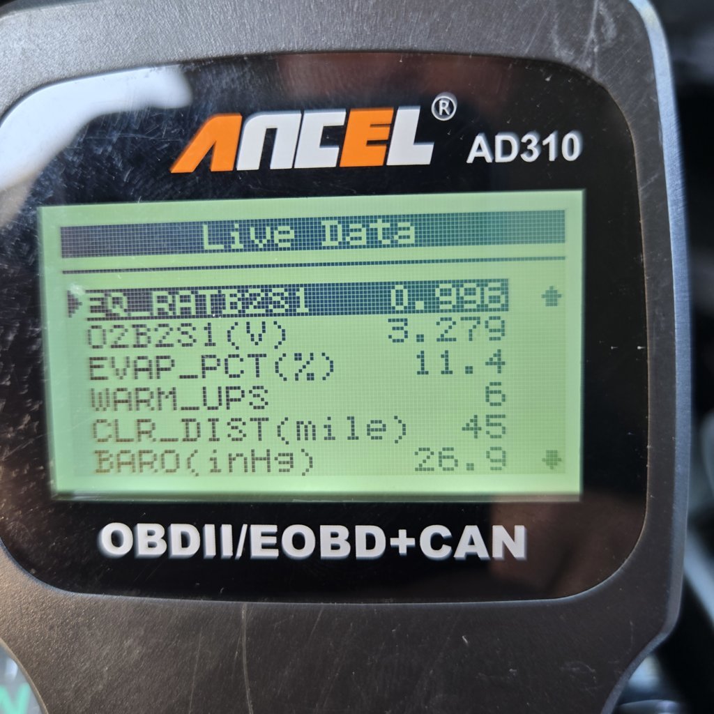

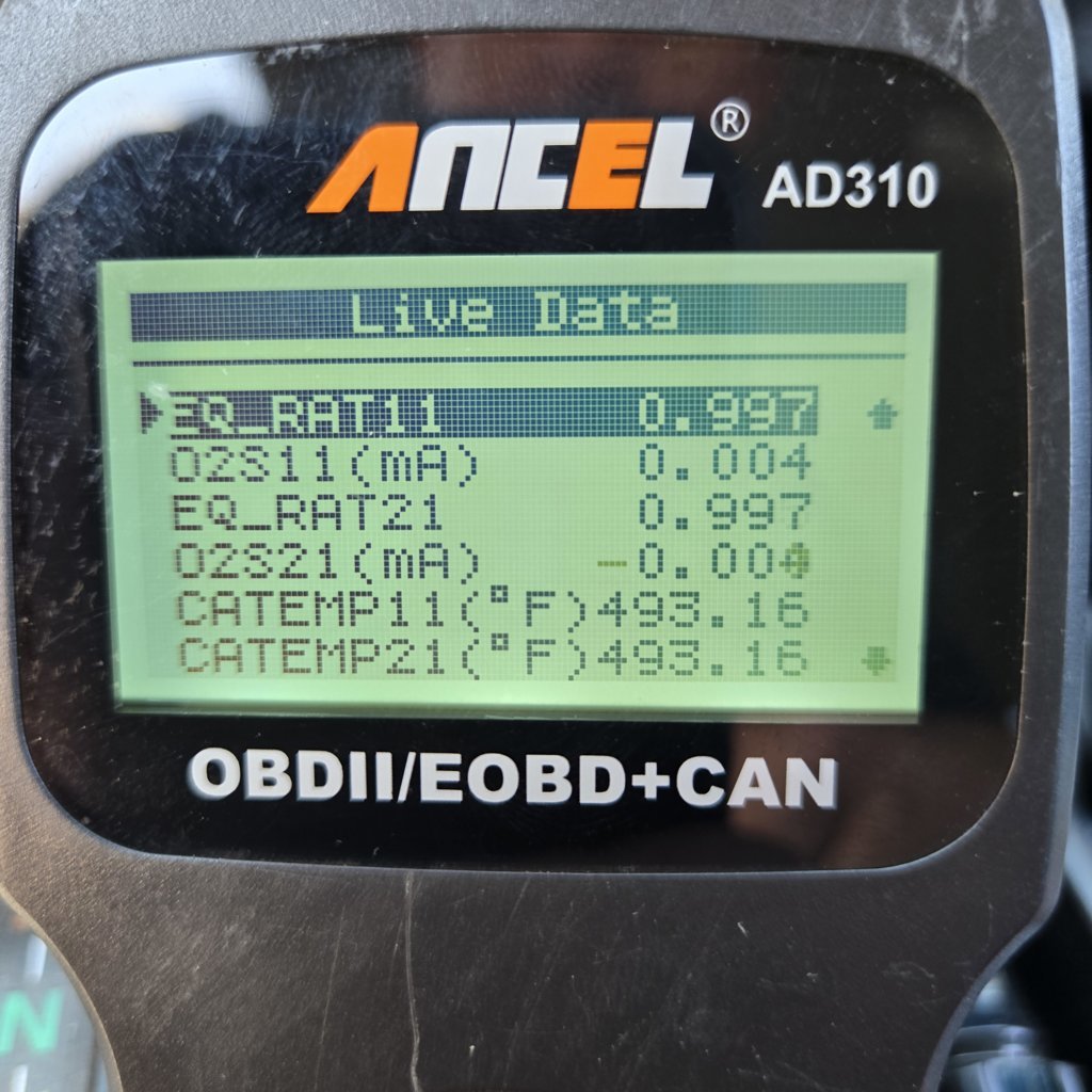

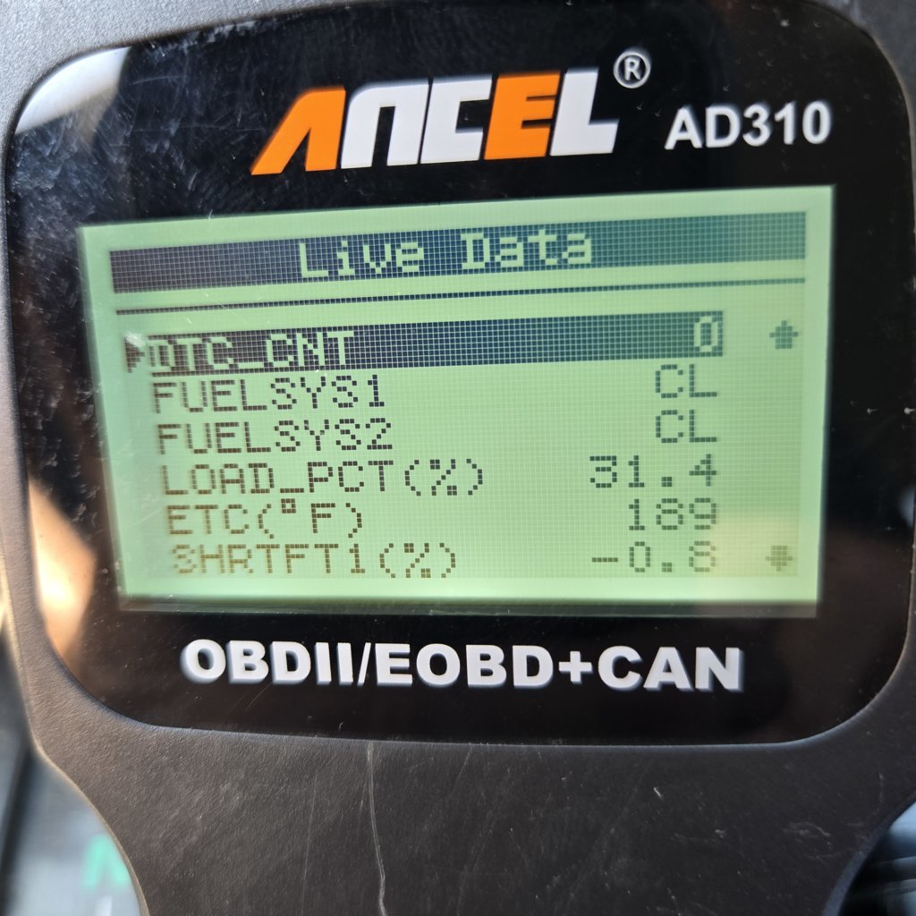

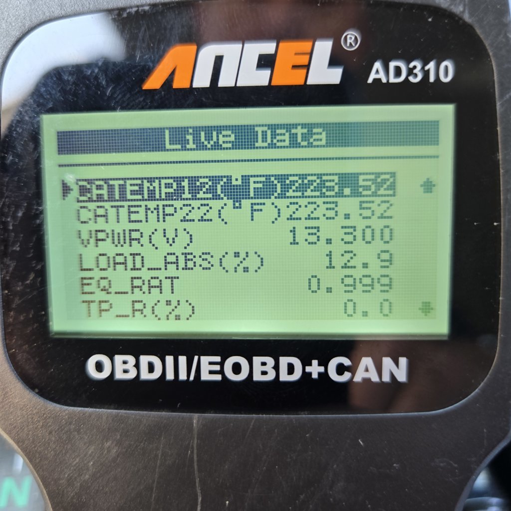

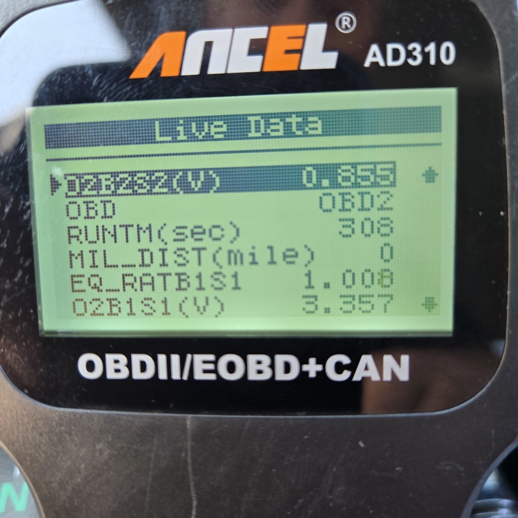

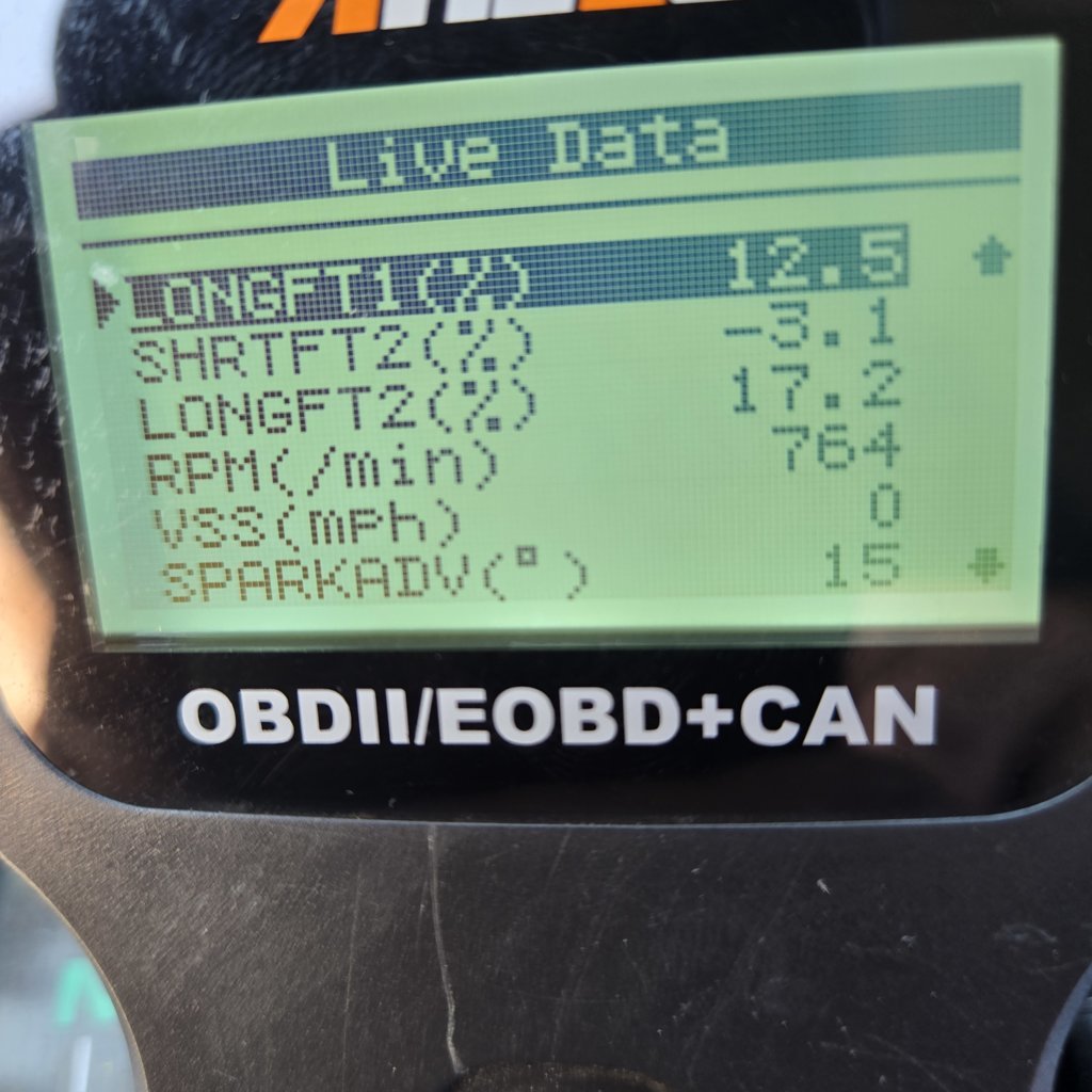

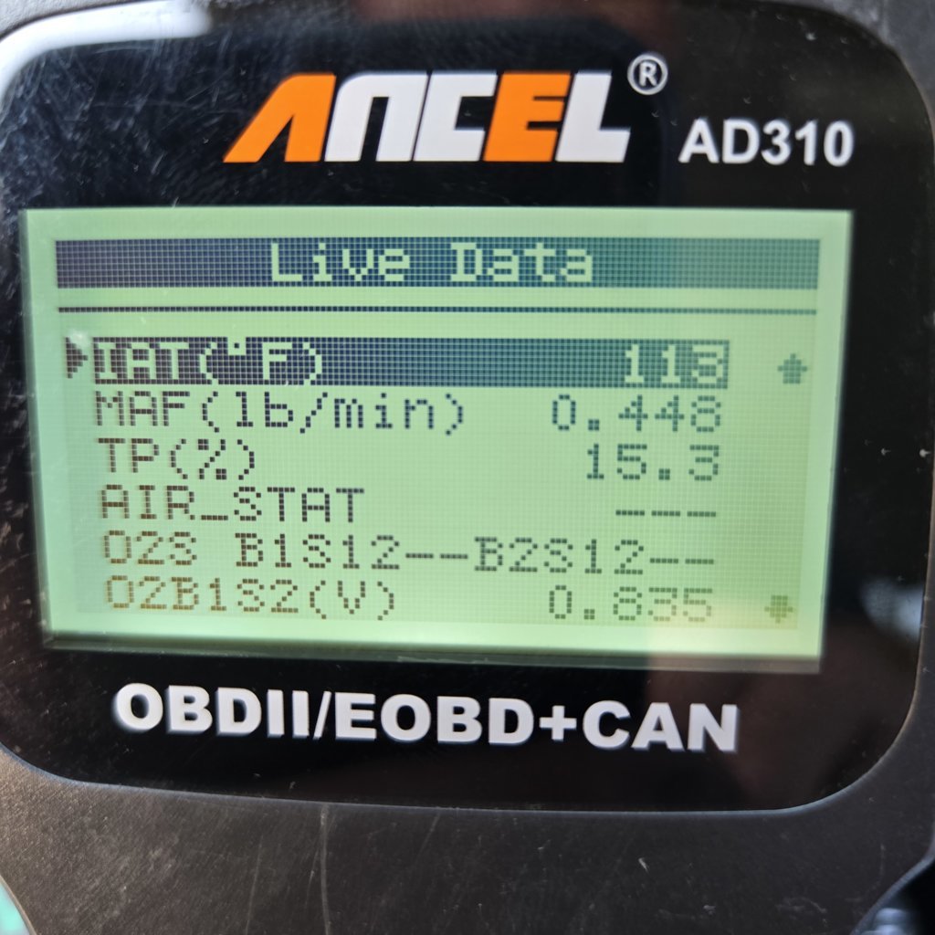

  19. Jul 23, 2025 at 3:55 PM
    #59
    madmax101
    madmax101 [OP] Well-Known Member
    Jul 19, 2024
    #453602
    46
    2013 silver tacoma
    This was Idling after I hooked the resistor back up and it through a P0102 code today coming home from work so I bought and installed a MAF sensor. The sensor reading before I changed it was at .5 not much change...

  20. Jul 23, 2025 at 4:15 PM
    #60
    Dm93
    Dm93 Test Don't Guess
    Mar 3, 2015
    #150066
    13,662
    Texas
    2014 DC OR 6spd 4x4
    Predator tube steps, Ranch Hand grill guard, Magnaflow CatBack exhaust, Toyota tool box & bed mat, 2LO Module by @Up2NoGood, Rearview Compass/Temp Mirror, Tune by @JustDSM.
    I wouldn't toss the old sensor yet, I bet it's not your issue.
    I'm kind of suspecting the EFI relay at this point, maybe check voltage drop between battery positive and the EFI No 2 Fuse (10A) with the truck running.
