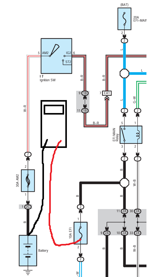

    No drop, 13.78v

    Probably not gona see anything when it's not acting up but when I say voltage drop I meant one lead to the fuse and the other to Battery Positive.
    Ideally we would have a 4 channel scope on 4 different spots in the circuit to see where out voltage drop is occurring in one go instead of checking things one at a time and hoping it acts up when we're testing.

    Gotcha, I have 3 good digital meters and two old analog meters. I unplugged every connector in the system and no burnt wires. I'm sure you are correct the MAF is not the problem. I replaced the fuel injection relay with a new one. I had a couple of new spares. I also unplugged the remote start. I know it's a lot of change at one time but elk season is rapidly approaching. I will retest the voltage drop in the morning, if it doesn't start on the first try.
