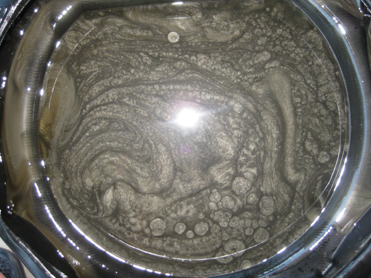

    I am not suggesting you have to or should change the gear lube or transmission fluid. I am only mentioning when and why I did.
    I did gear lube change in front and rear diffs and transfer case at 5000 miles. If i had to do it again I would skip the front and transfer case since the lube look just fine and could easily go the 30K toyota schedule. But i had purchased all the gear lube and it gave me a chance to break loose the stubborn front diff drain plug and replace with a regular hex nut version used on lexus vehicles instead of the trouble prone 10 mm allen key version.But what came out of the rear diff wasn't something i wouldn't like to leave in there for 30K or forever. It was full of shiny metal particles which didn't surprise me since ring and pinion gears do naturally wear in together. The magnetic drain plug was full. I cant see this metallic soup being healthy for either the differential bearings or axle seals.
    Now that this initial change was done i can go like 60K based on Amsoil recommendations (i dont currently tow)
    Cost to do all was about $80 for Amsoil severe gear 75W90 and $10 for the crush washer/gasket set. But as I mentioned the front diff and transfer case were not really needed so you can cut that cost down to $40 if you just do the rear diff.
    I do a 3+ quart drain and fill on transmission every 20 K which cost me like $30 for the WS fluid. I have an ultra gauge to monitor the ATF temp so getting the fluid level correct is quite easy. I combine this activity with greasing all the zerks on the driveshaft since I am down there already. Takes maybe an hour on a weekend so no big deal. Overkill probably but cost is so small its not an issue. To add to the "overkill" i have an inline magnefine filter and additional thermostat controlled secondary transmission cooler that only kicks in when temp exceeds 180F.
    So $1800 is insane. You can get everything needed for $100 or less for absolutely everything.
    Would you want to leave THIS in there for 30K or forever??

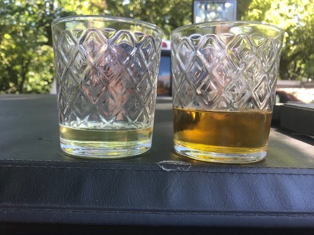

    Since I am retired and am only putting on maybe 3000 miles a year I base by fluid changes on mileage rather than time or I would be doing oil changes every 1500 miles (6 months)
    The exception is brake fluid. That I flush at home every two years regardless of mileage. Its a hygroscopic fluid that absorbs water based on time rather that usage. So over time you end up with a higher percentage of water content. This lowers the boiling point and can promote corrosion in all parts of the system. The ABS module is full of lots of parts that are sensitive to corrosion and in Canada that module is $2400 (almost $2800 with tax). And three bottles of DOT 3 brake fluid only cost $24
    Thats why even toyota recommends flushing it every 2-3 years. I used to do it with my sons help (operating the brake pedal) every two years during my spring switchover from my snow tires to my summers since I have the wheels off anyway.
    Now that i added stainless speed bleeder screws on all four corners I can now do it myself in about 1.5 hrs which includes the time to jack up and swap tires as well. I went for the stainless speed bleeders since I have heard of many cases where the bleeder screws become so corroded they snap of when trying to open them which can sometime require replacing the whole caliper.
    http://www.speedbleeder.com/size.htm
    Brake fluid at two year vs new
