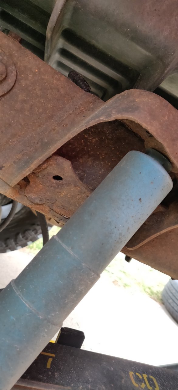

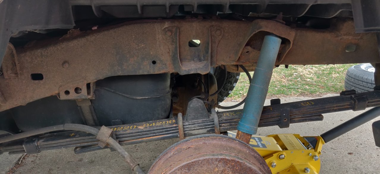

    My biggest issue however is frame rust.
    Two years ago my rails where very clean. I took very good care of the frame fails due to the noterity of Tacoma Rust issues. Whelp, true to fork, I had the recall work done, they spray rust attracting shit on my truck now I have orange rails.
    Not bad by Midwest standards, but I need to do something, just not sure what.

    Best option financially? Hit the rust with a wire brush and some rustoelum and keep on driving.
    If that sounds worse than dropping 35k+ on a new truck then by all means go for it.

    But I've always been told that will speed it up. Wire wheels embed soft metal from the wheel, rustoleum will just chip and trap moisture between the paint and fresh layer of bare metal.
    So many products and options, but I've never seen a definitive answer. POR15, Eastwoods list of products, etc. And if you can't get all of it, inside, upper areas, etc.. It's just going to keep spreading and rotting.

    Keep the taco. you could replace the frame for a lot less then a new truck. Por 15 works great on this application.

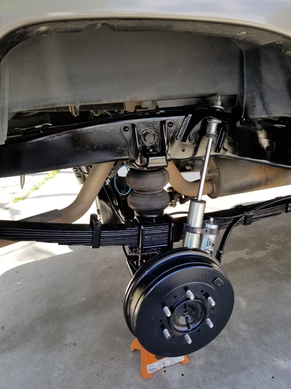

    Do this and your truck will last for many years. Thick epoxy paint. This is my 2012.

    Hit your frame, existing surface rust and all, with fluid film. Use the nozzle to get inside the crevices. FF will cover the existing surface rust and isolate the frame's metal from the oxygen/water/salt that wants to return it to FeO2 (rust). Do this every fall. Note - FF is tenacious. If you later decide to paint you'll want to use some degreaser to remove it.

    I had a 1997 4runner with rust in Wisconsin. I convinced someone to sandblast it, body on. Wire wheeled the rest then hand painted several layers of Eastwood’s two stage epoxy. Excellent product. Frame was back to new, but the trick in the Midwest is washing the undercarriage every single week in the winter.
