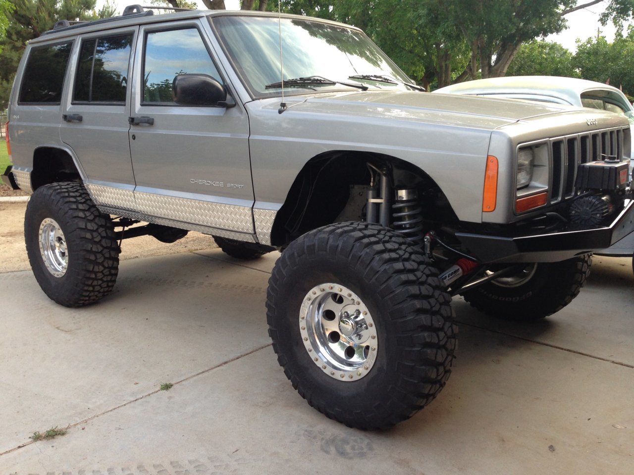

    Been using this for years and never had a problem. Here is a Jeep that has been painted like this for over 10 years. Never cracked or chipped.

    You don’t live in the rust belt though. I love that Jeep, my uncle has an XJ with about 300k on it. It’s had a little work done, but that thing just keeps on going.

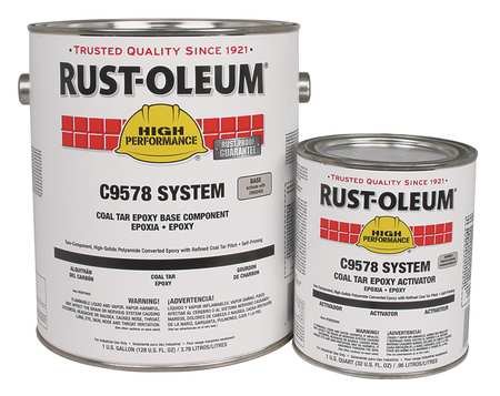

    It's also not a rubber coating. It's a heavy duty paint.

    True, no rust belt here. Sold the XJ for a pretty penny also.

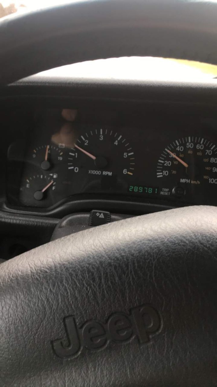

    This was the last time I drove my Uncles XJ, back in December.

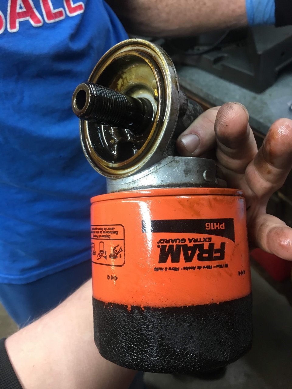

    How many times have you swapped out the oil filter adapter O-rings? This pic is from his newer XJ, I think it’s an 01 with around 50k original miles. It had a cracked head when he bought it (didn’t know it), somebody had added a bunch of radiator quick fix to it and it started overheating soon after he bought it. He flushed the cooling system multiple times and put a new head and radiator and thermostat in it and hasn’t had any more trouble. They think some of the stopleak got into the engine though, you can see the buildup in the oil filter adapter. It seems to run ok now, but it does have low oil pressure. He runs 10w30 and a quart of Lucas oil stabilizer to bring the oil pressure up a bit. It’s doing Ok so far. I think he regrets buying it, but he didn’t know it had head problems when he bought it. It must have had the 0331 head and somebody dumped a bunch of quick fix junk in it and traded it in.

    That oring is at the block. Never had to replace that one. It never leaked.

    diamondkote.com
    Sounds fancy. I will stick with my Rustoleum paint.
