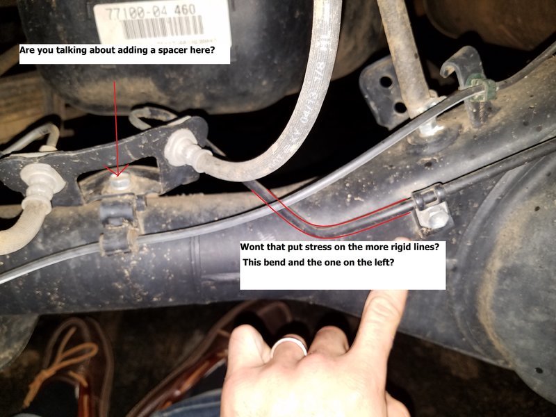

  15. Mar 6, 2017 at 8:36 PM
    CrashN'Burn
    CrashN'Burn I used to have a life
    Oct 27, 2016
    #200883
    2,446
    Joshua
    Union City, CA
    '13 TRD Sport MGM
    Okay I just went out and crawled under to understand, do you mean like this?
  16. Mar 6, 2017 at 8:39 PM
    #16
    anthony250f
    anthony250f Well-Known Member
    Feb 18, 2012
    #73066
    16,738
    Anthony
    San Diego, CA
    2008 dcsb trd offroad 4wd
    Yup added it under the bracket and used a longer bolt...believe I did that because the flare nut rounded
