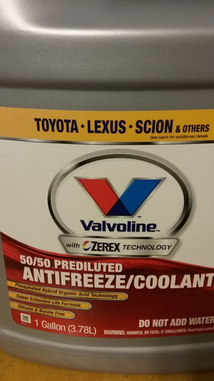

    That said...I did mine at 55k miles (3.5 years). Don't waste your time and money on the factory juice. For about $13 a gallon you can get Valvoline Zerex at Walmart. It's premixed and is a silicate free, P-HOAT formula just like the SLLC. It's a perfect match.
    My system is in excellent shape. So no flush for me. I did 3 DAFs over the course of a week or so. About every couple of years I'll do a DAF to keep it fresh.
