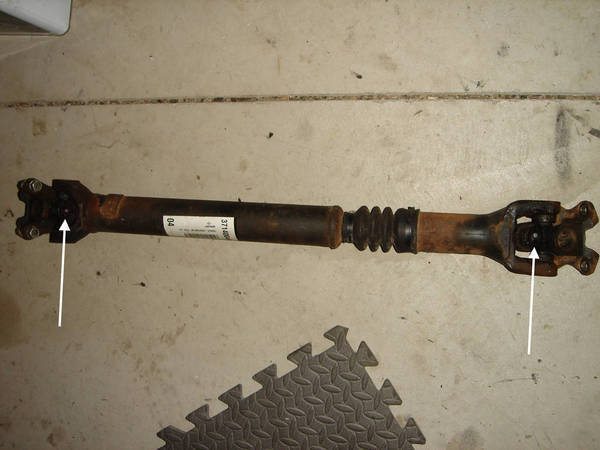

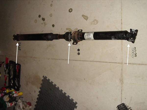

    4x4 Tacoma's have 5 grease points (zerks) - 3 on the rear drive-shaft at each u joint and 2 on the front drive-shaft at the u joints. No zerks at the slip yokes - u joints only.
    2wd Tacoma's, including Pre Runners, have no grease zerks.

    The main shaft has the zerks on the outside of the U-Joint and they all point the same way. If you found one, you found them all.
    The front shaft has the zerks on the face of the U-joint so they are harder to see. They are also installed from the factory in the same orientation.
    My truck doesn't have the rear sliding yoke, the front one is sealed w/o a grease fitting.
