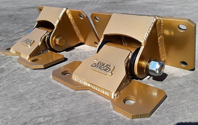

    Why doesn't everyone install these?
    167265096_455758048874396_25185358265475_3920cce869efe085dc5c16dd903fd0c2b22cab3e.jpg
    Torspd[QUOTED] likes this.

    Those that really push their trucks the the limits, usually do, or have. They are quality. :thumbsup:
