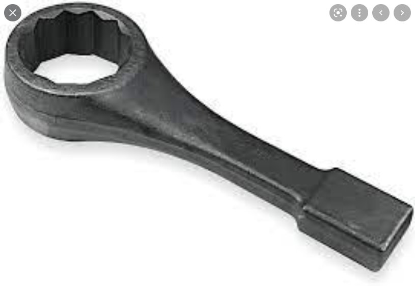

    How much of a bitch is it to remove the old sensors? Any particular socket for this task that Taco World likes?

    The upstream ones at least are easy to access. I am worried how tight they might be after 185k mikes though.

    A slugging wrench works wonders. Sometimes with a little judicious heat. You can usually get a used 22mm off fleabay for short money. They also come six sided, though it's kind of rare. I have both a 12 point and a 6 point, and they both work equally well without rounding corners. Just a whack or two is usually all that's needed. Once it starts moving, use some Kroil or whatever to seep into the threads so you don't gall it.
