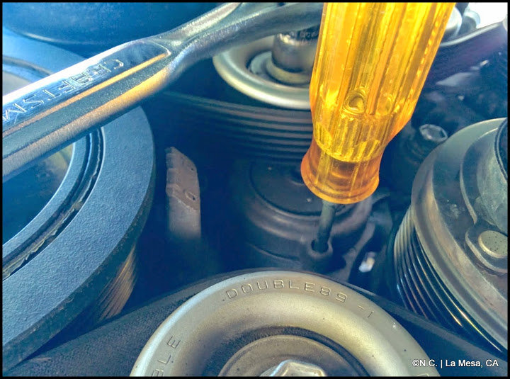

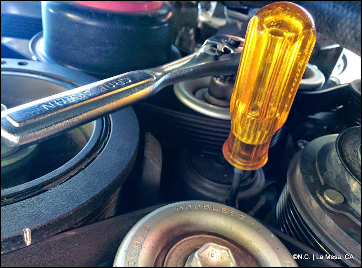

    how do you change belt?
    Routing diagram for 2nd Gen Tacoma
    2005_Tayota_Tacoma_4.0_Serpentine_Belt_0_3e2669bc055b020503b40262e0f94e46fcaf28b2.gif
    Used a ratchet on the belt tensioner to align the hole to place a screwdriver in. Then take the belt off and replace.
    Install is very straight forward after reading Derk's instructions.
    A closer view of the screwdriver locking up the tensioner.
