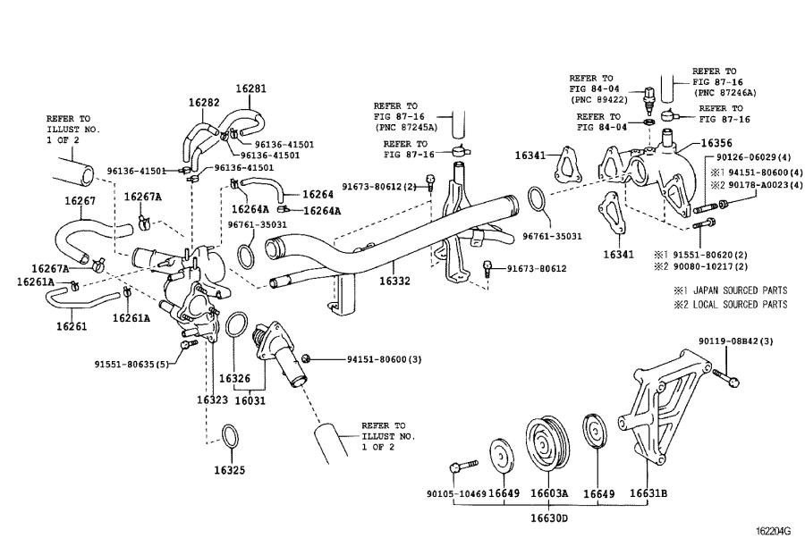

    Honestly I've never head of a coolant hose leaking underneath the intake manifold, I know there is a steel coolant tube that runs between the intake gally and feeds coolant to the heads. There is an o ring on that steel tube that is replaced along with the waterpump (included in the waterpump kit). The smaller coolant lines that feed the throttle body are the only hoses that I know that run next to the intake manifold, but those never really leak unless the technician forgets to put the clamps back in the proper place.

    Heres is that steel tube and coolant bypass
