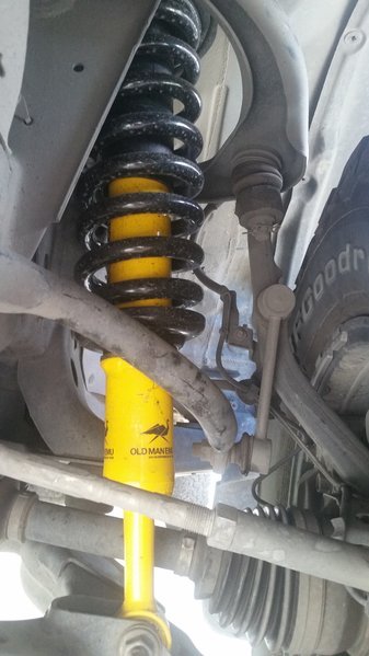

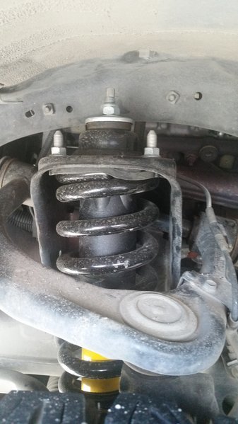

    Got pics of your front shock / coil set up ? Any chance the coil seats are upside down ?
    Here they are. Look right to me but I'm not the expert, paid @HeadStrong Off-Road for strut assembly to avoid that problem!
