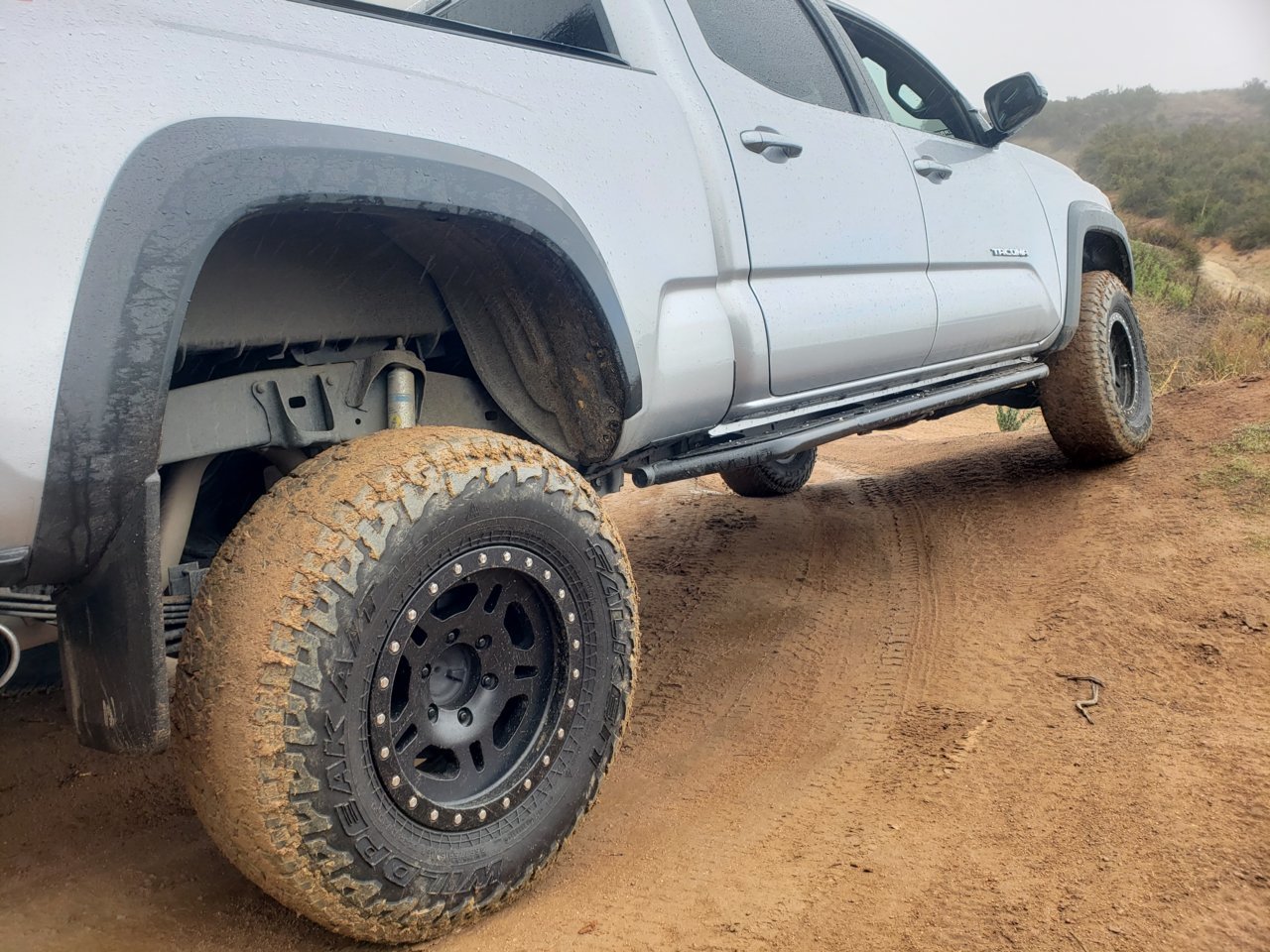

  4. Feb 11, 2020 at 3:06 PM
    #24
    Cudgel
    Cudgel “Tonka”
    Mar 28, 2017
    #214640
    4,313
    Live in: An Ocean of Plastic Trash
    2017 OR DCLB
    ICON8 Lift -285s. upTOPoverland rack.
    2”+ on droop.
