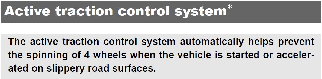

    Too many people for various reasons conflate the term “crawl control” with the set of traction control aids available on the taco. I have no personal experience with crawl control because I have a manual transmission, but I have lots of experience with ATRAC (off road traction control) and I can say that it is lot better than an open diff and also better than TRAC (on road traction control).
