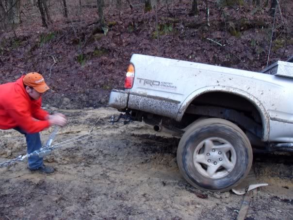

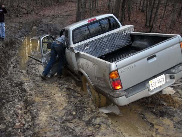

    well for those of us that dont have winches, i have found a comealong to be a great help as well as the custom floor mats i made out of old carpet in the garage. other than that, like everyone else said, start digging. here is an example of me using both tactics at once!
    notice the comealong and carpet being used together for maximum efficiency
    notice the carpet taken directly from my truck
