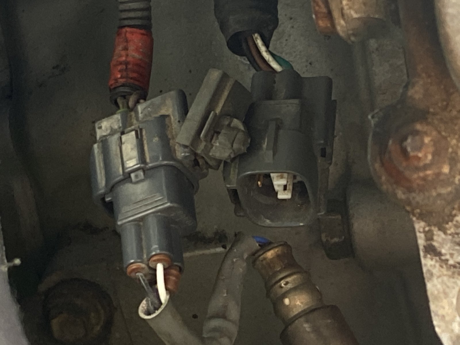

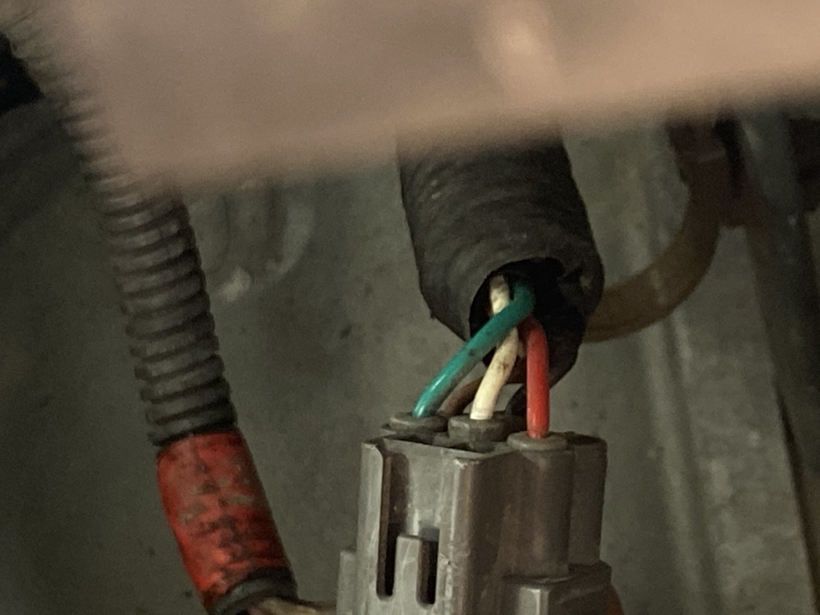

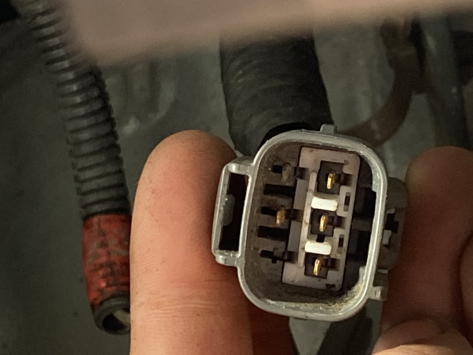

    Did a motor swap on this 4.0 2006 Tacoma. I have already started it up and drove it but I noticed that this plug wasn’t going to anything and doesn’t have anything around it that I can see for it to go too. Located on passenger side right beside o2 sensor on manifold. Wire colors are green, red, white, black and a brownish tan color. Thanks guys

    Connector EE1, it goes to the knock sensor harness that is in the valley of the engine.
