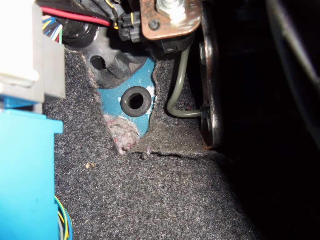

    I drilled a 1/2" hole in my firewall by the clutch pedal right below the main grommet and used that to run all my wires. Ran probaby 10 wires through there or better with room for more.
    There's also a solid grommet on the passenger side that already has a blank hole in it, I reemed it out a bit larger and installed a new grommet.

    I did this too, but also put some silicone sealant around it.

    PSUTaco 85 thank you that's exactly what I needed to know

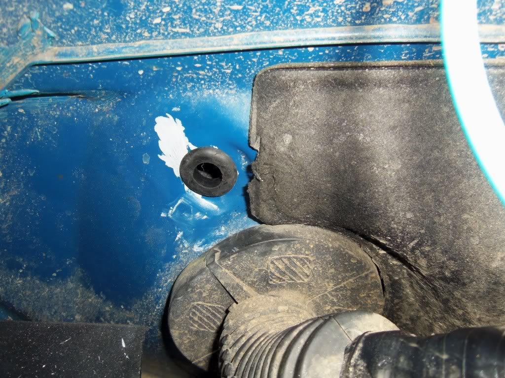

    I used the hole that is right behind the master cylinder. The grommet was too small to re-use as a protector of the wires so I ran split duct through the existing hole in the firewall and left about 3 inches exposed inside the cab. I did have to cut a small "X" into the carpet.
