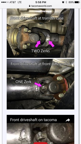

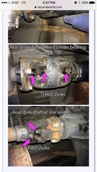

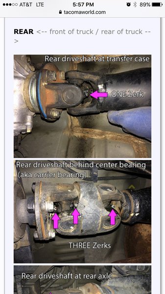

    maybe upper and lower ball joints ( don't recall if stock had them) all joints on both driveshafts, if yours has a Double Cardan at transfer case, there is a fitting in the center also
    thats about it fittings are in center of joint crosses

    There are none on he actual front suspension parts unless aftermarket parts have been installed. Only the drive shafts from the transfer cases have them I believe. At least those are the only ones I have greased for the last 15 years....

    I notice my front ball joints don't have grease fittings.The popping might be coming from the front universal joint that attaches to the transfer case.

    the only grease fittings on my 04 were on the u-joints...
