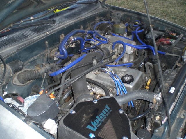

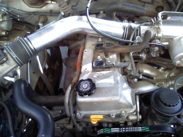

    On the last leg of the intake pipe there is a hard 90 elbow nipple that then runs via a rubber hose to the bottom of the throttle body
    Some people have done custom intakes getting rid of all the resonator stuff, I want to do that too. If you don't cut and reuse the last hard pipe with the nipple I mentioned above, you would have to re route that line I mentioned, where/how are people doing that?

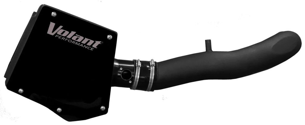

    K & N puts in front I guess
    mine has it where its supposed to be
    Kinda like this one.....
    most aftermarket intake tubes worth a crap will have that outlet on back side and usually a smaller one on the front side for the evap sys to get fresh air

    I'm not buying a cold air intake, I'm using a $25 intake pipe to my stock airbox as seen in the 2nd pic in the original post. But the guy in that pic obviously rerouted that IAC hose somewhere, I am asking if anyone knows where?

    I'm not sure what you've been trying to get at this whole time, but it's not exactly helpful. In that 2nd image in the OP that guy doesn't have a visible IAC hose coming off his pipe, so I was wondering if someone had an idea how he did that, since I can't ask him. I've had to hack up my intake to fit it around my long travel shocks and hoops. I want to clean it up and that is going to involve some custom intake piping, I figured I'd replicate that dude if I could.
