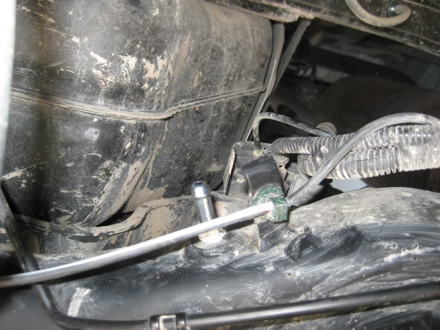

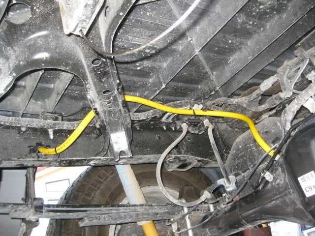

    The front breathers are already extended high up...
    For what-ever reason, the rear differential is not (the rear locker motor has an extended breather that disappears in the truck frame... higher than the differential.

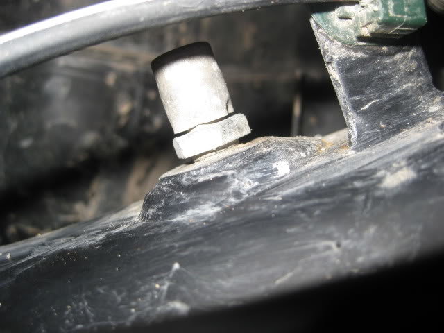

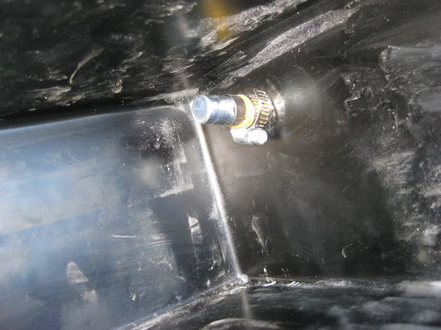

    Here is the (removed) rear breather... and a new front breather, used when the rear is extended, at the end of the tube:

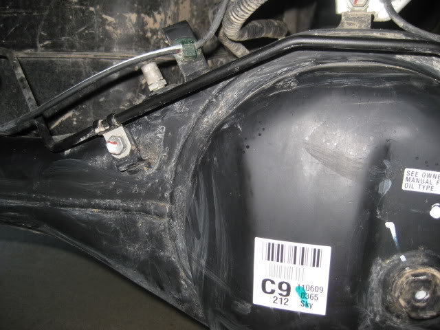

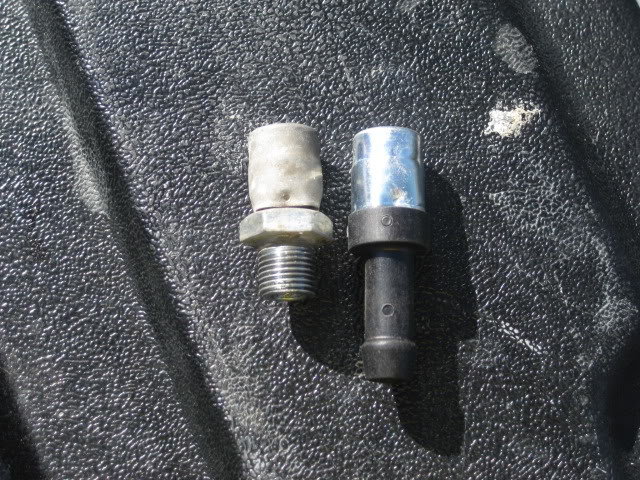

    Here is the new 'union' installed on the rear differential:

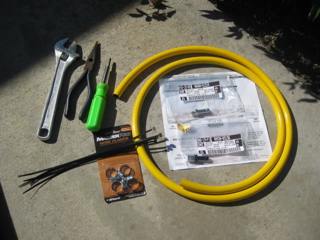

    Here are what you need for the rear differential mod:

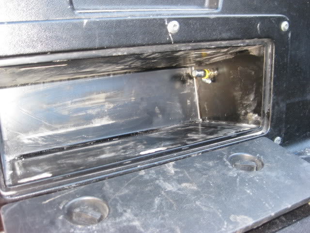

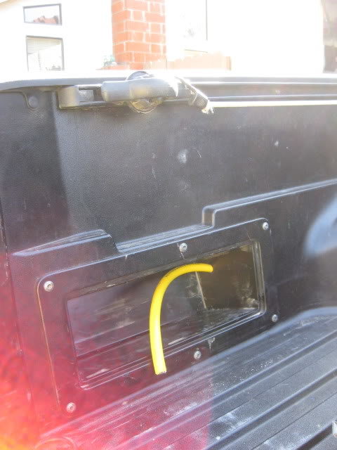

    I located the extended breather in the side compartment instead of the gasoline fill bay, as others did.
    It has been fine there... no signs of oil, ever.
    Even after fun off roading!
    If you want more details on this mod with prices, etc. , just click on the link to it in my signature, below!
