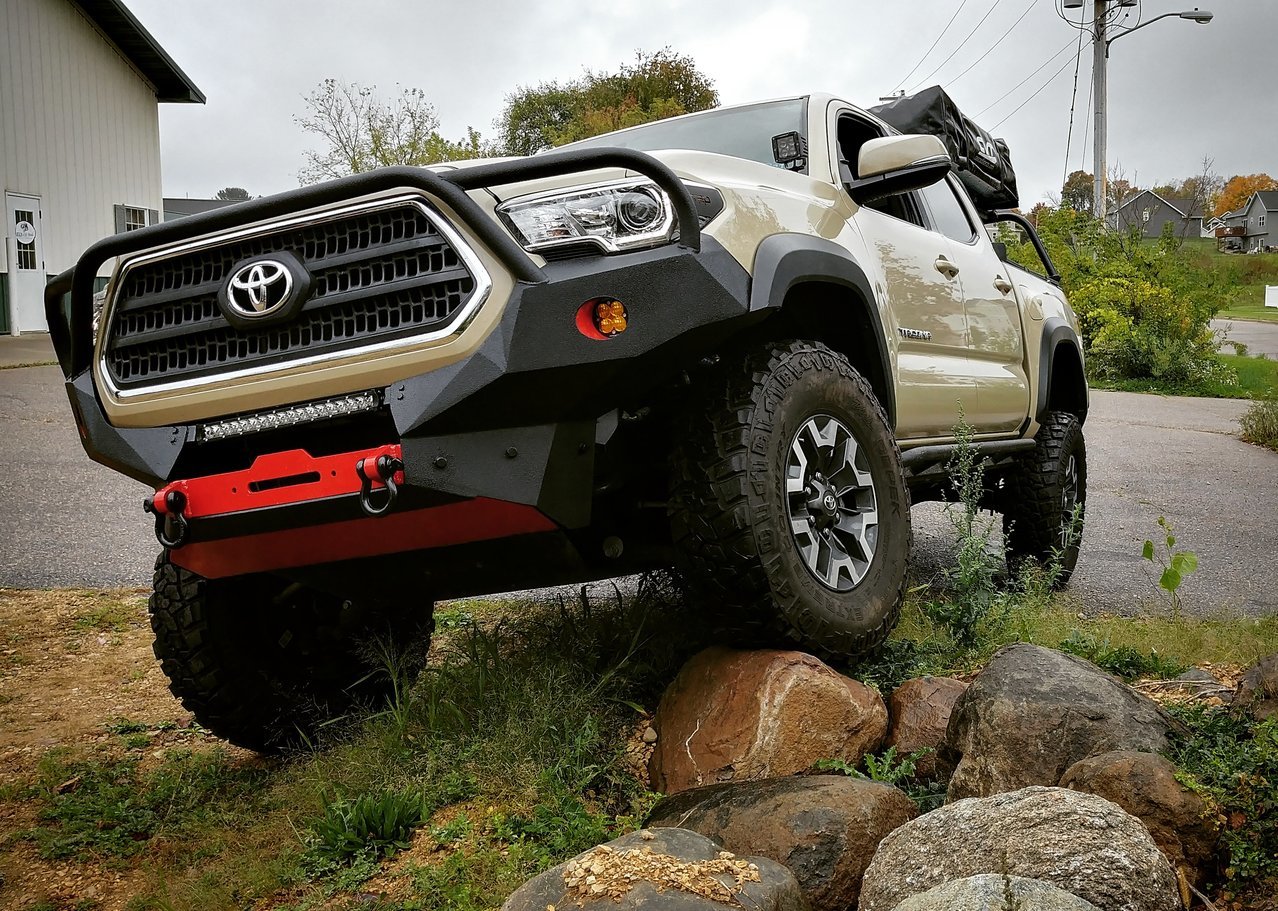

    Wow that looks busy! Don't mean that in a negative way. It looks like solid fab work

    More pics? I've curious about that red box on the bottom

    It's definitely most noticable there with the light rain and reflections. Much smoother in person, at least I think so.
    Sure, the shop has a set of pictures on their facebook and I've uploaded a fair amount to the "what have you done to your 3rd gen" thread if you go to my profile.

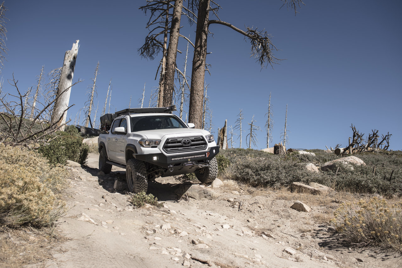

    white mudflap

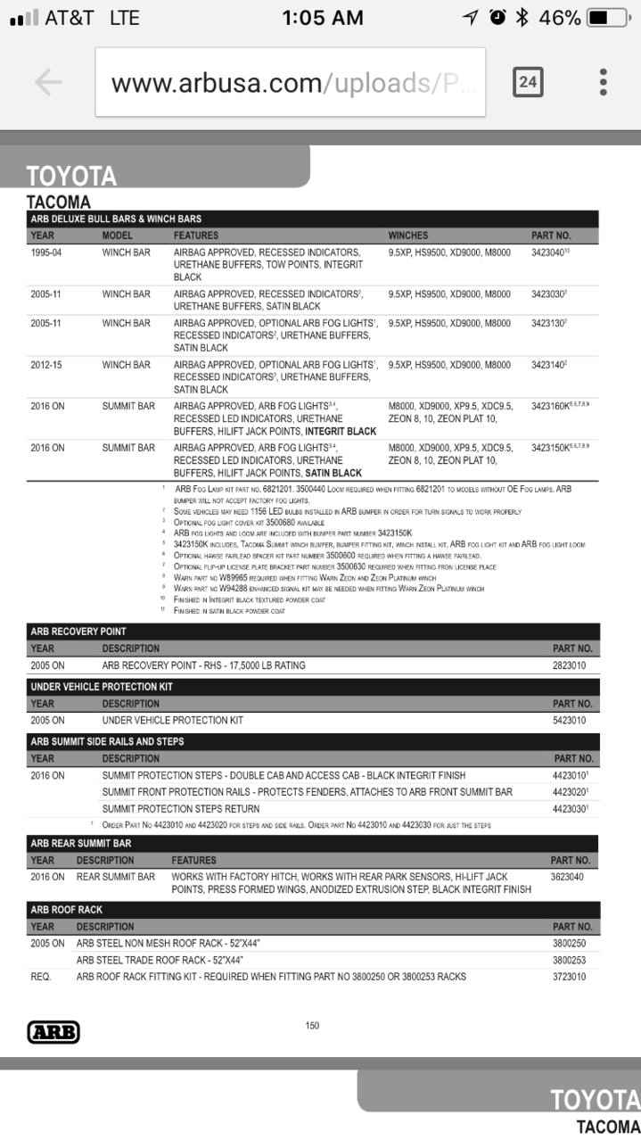

    ARB Summit bumper specific question.
    I ordered my ARB bumper on 12/15 from an Amazon vendor.
    I received the bumper itself on 12/17.
    I have yet to receive the mounting hardware, fog light kit, indicator lights ect..
    When I have ordered these bumpers in the past they were shipped with everything in a big box for the more recent ones or in a wooden crate in the early 1990s.
    My question is... Is it common now for the bumper to be shipped separately from the mounting hardware or did mine fall off the (junky, broken) pallet somewhere?
    @Jfox440261
    @Quicksand Jesus
    @FoleySwampPlotts

    IIRC ARB's fog/fog bezels were sold separately?

    3423150 bumper comes with filler panels for the fog lamp holes.
    3423150K comes with all the bells and whistles included according to ARB. This is the part number that I ordered. I have not received anything other than the bumper itself. No brackets. No hardware. No lights. No harness.

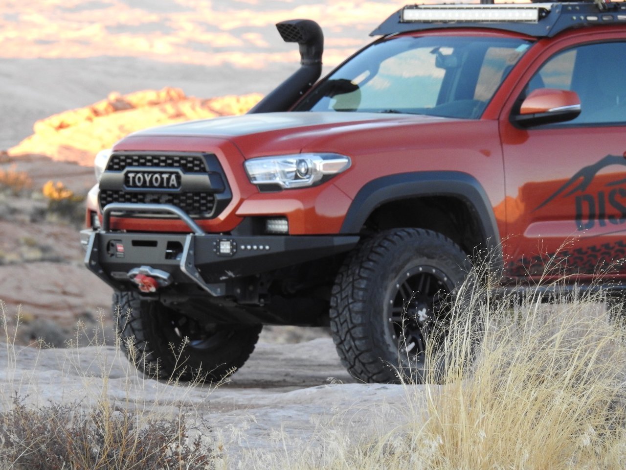

    100% agree!
    These tuck bodys move even more that previous models. Here a good example of how much, when the truck is on flat ground my body to bumper gap is about 1/2"-5/8" in this photo one side is touching and the other is now a couple inches away. Like you said, I don't see this ending well with the full replacement bumpers that don't have proper clearances. IMG_0053.jpg

    I just noticed this on my truck after some mild off-roading. The body flexed so much and contacted the bumper...there is rubbing marks on both sides where they meet. Also, from the flexing it snapped my passenger side headlight brackets.:frusty:

    Yeah, imo the gaps need to be tight to pull off the look of a full replacement bumper, unfortunately these truck need at least 5/8" clearance and that would not look right so manufacturers close the gaps without thinking of the consequences. This is one of many reasons I will not offer a full replacement bumper for these trucks. You will start to see more and more reports of damages caused from improper body gaps as time goes on, the same thing happened in the 5th gen 4Runner threads.
    If it touches with minor off-roading imagine what would happen in a minor collision.

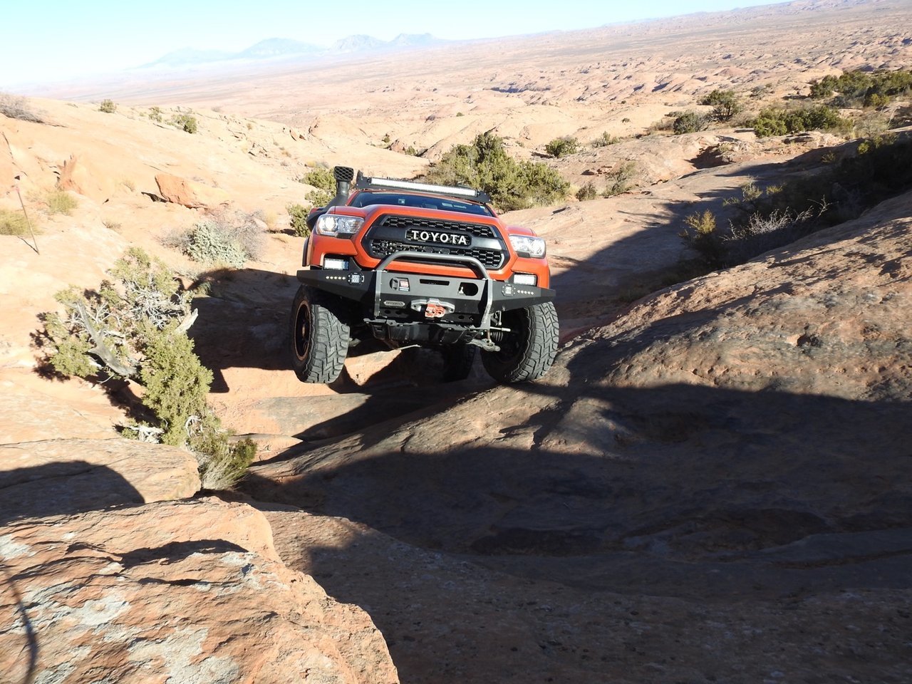

    I do plan to offer the bumper that I have on my truck, this is not a full replacement bumper. Full replacement means the entire factory bumper gets replaced and no trimming is required.
    The bumper I plan to offer will require trimming as well as all the one you mentioned above. IMG_0048.jpg

    Again, love the look of your bumper.
