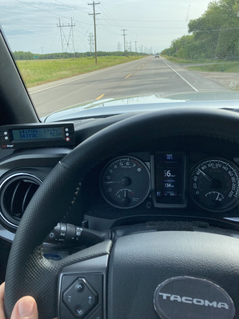

    I moved mine over from the steering column to left side of dash. Currently looking at
    pan temp
    torque conv temp
    coolant temp
    current gear.

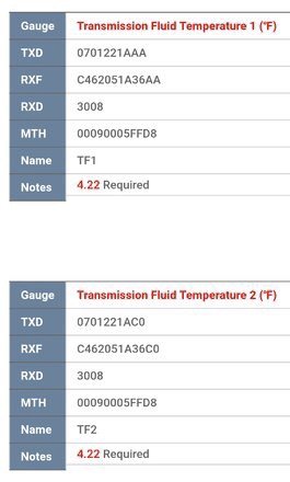

    These codes work for me:

    Hope it works. Just noticed that those codes work on a 3g. Hope they’re good for yours as well.

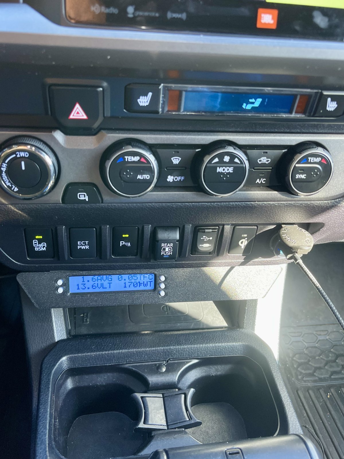

    I covered up the side cubby hole thats never been used.
    Engine oil temp Water temp
    Trans temp pan Trans temp converter

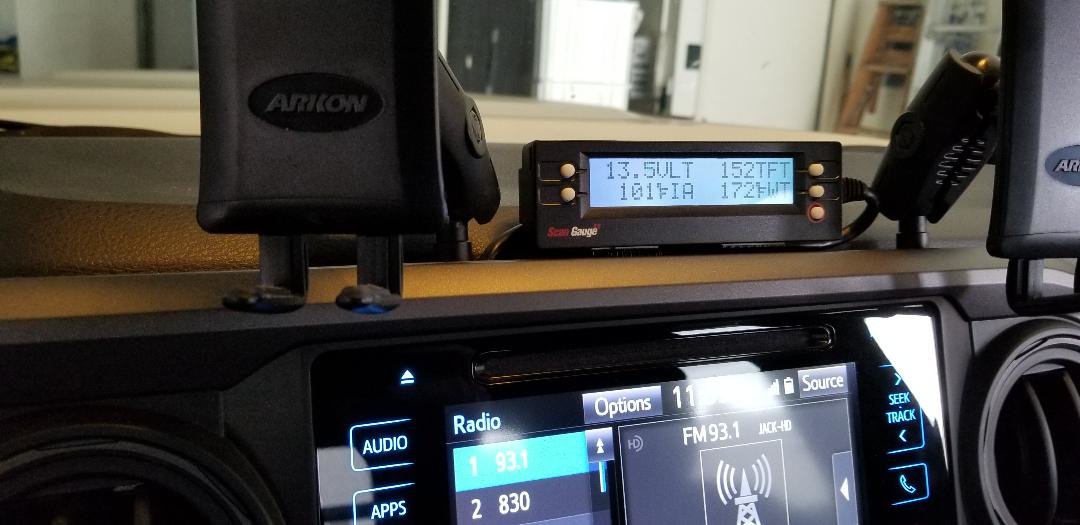

    New mount from illjimae.
    So clean, no more velcro.
