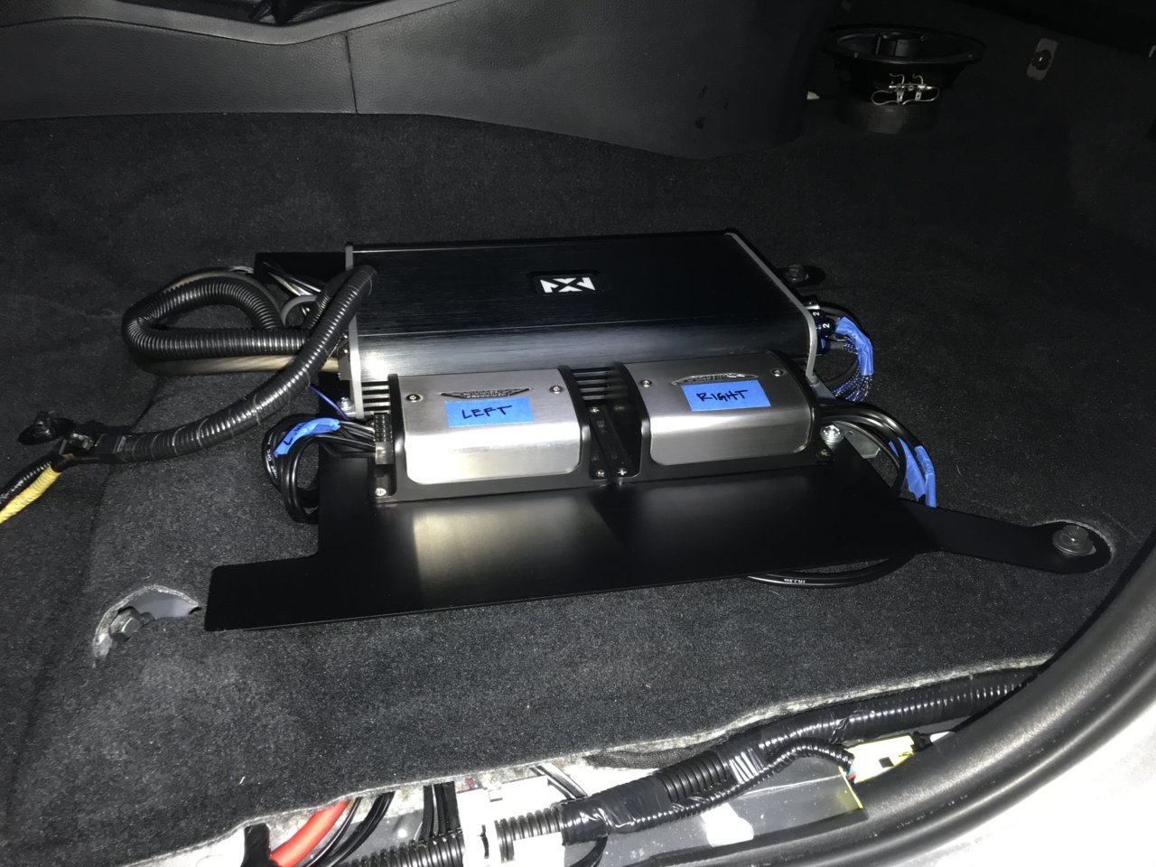

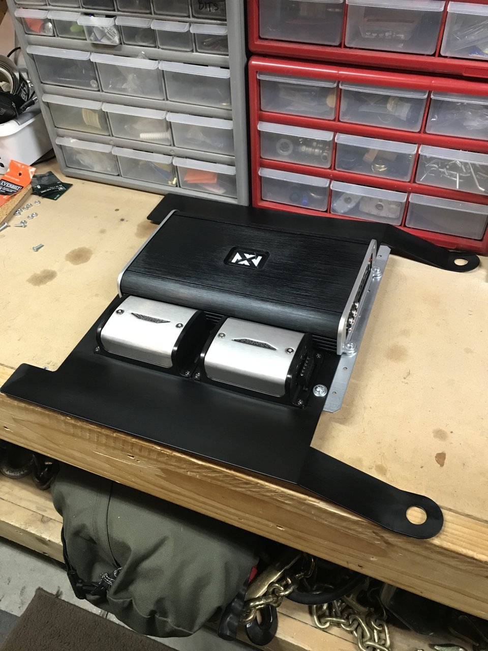

    Rack under my driver seat works well. There are vents on the floor to deal with so the rack suspends over those. BDF049EE-BEB1-4F99-AF81-5E634731E278.jpg C989CE8E-0D36-4831-97D0-C960FD8B4C7F.jpg

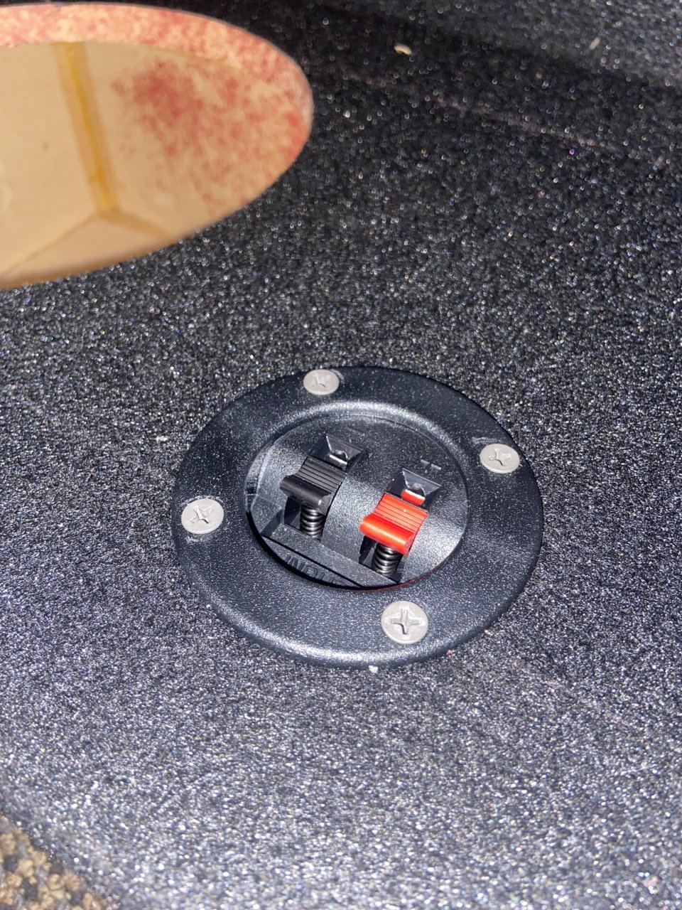

    Some YouTube gurus say to silicone-seal the inside of the terminals within the subwoofer box to prevent “air leaks”. Is that necessary? These terminals do have a cheap, soft foam gasket on their mounting surface
