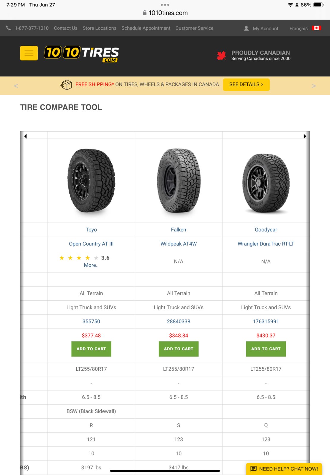

    255/80/17 looks like a good option! I hadn't been able to find an option that was so close in diameter and significantly thinner. Something to consider. Thank you!

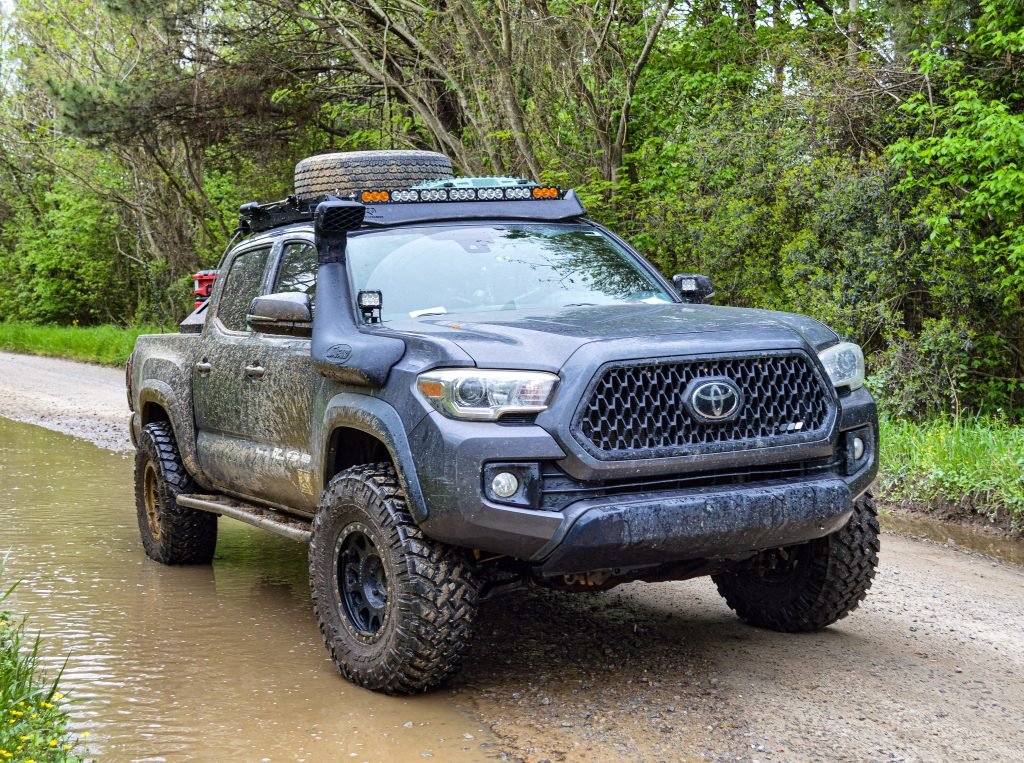

    Roof rack mounted

    That's what I plan to get, limited options in 3 peak mountain snowflake. IMG_0278.png

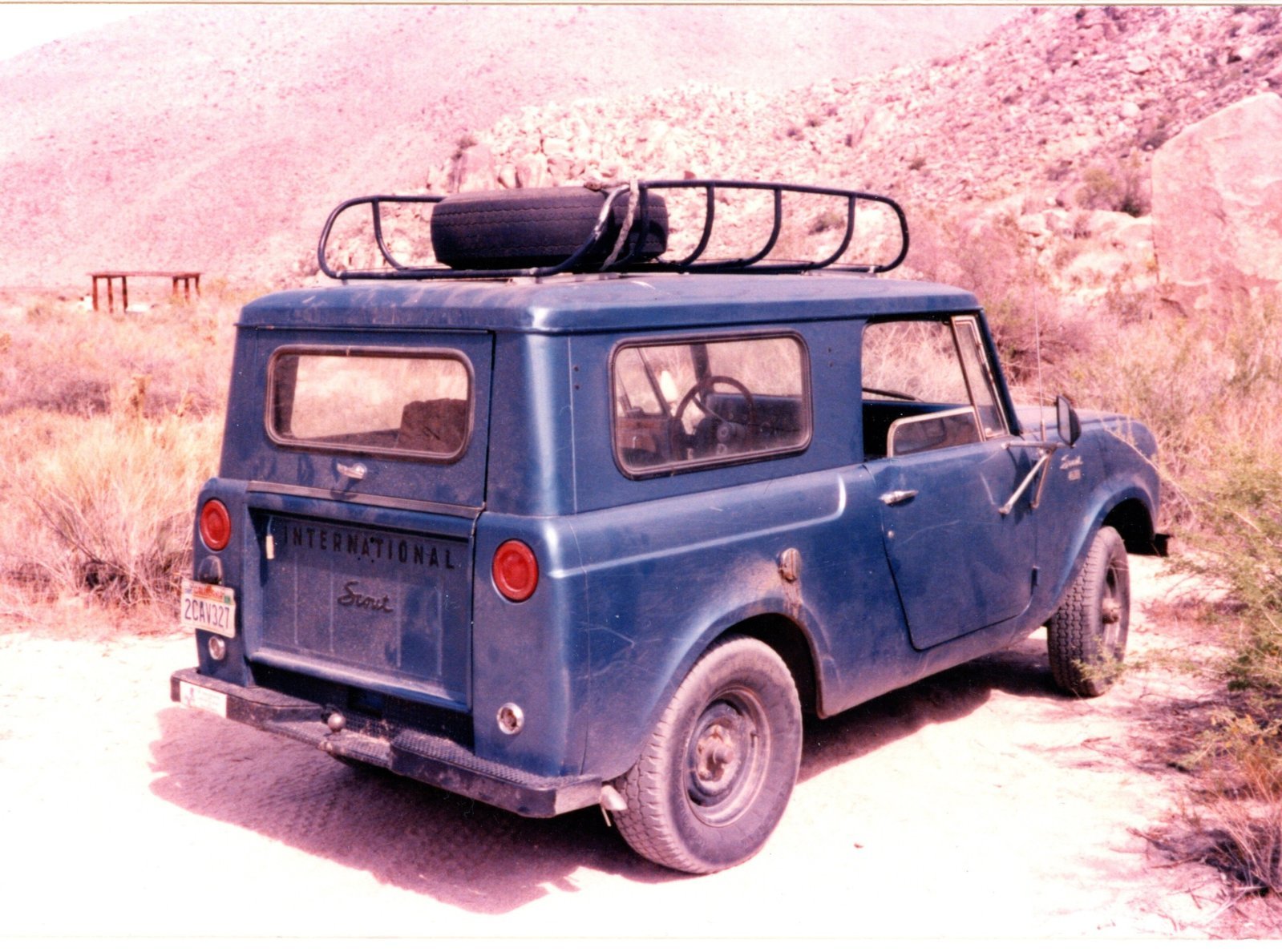

    That's what I did ages ago on my Scout. Eventually built a swing-out mount for the back.

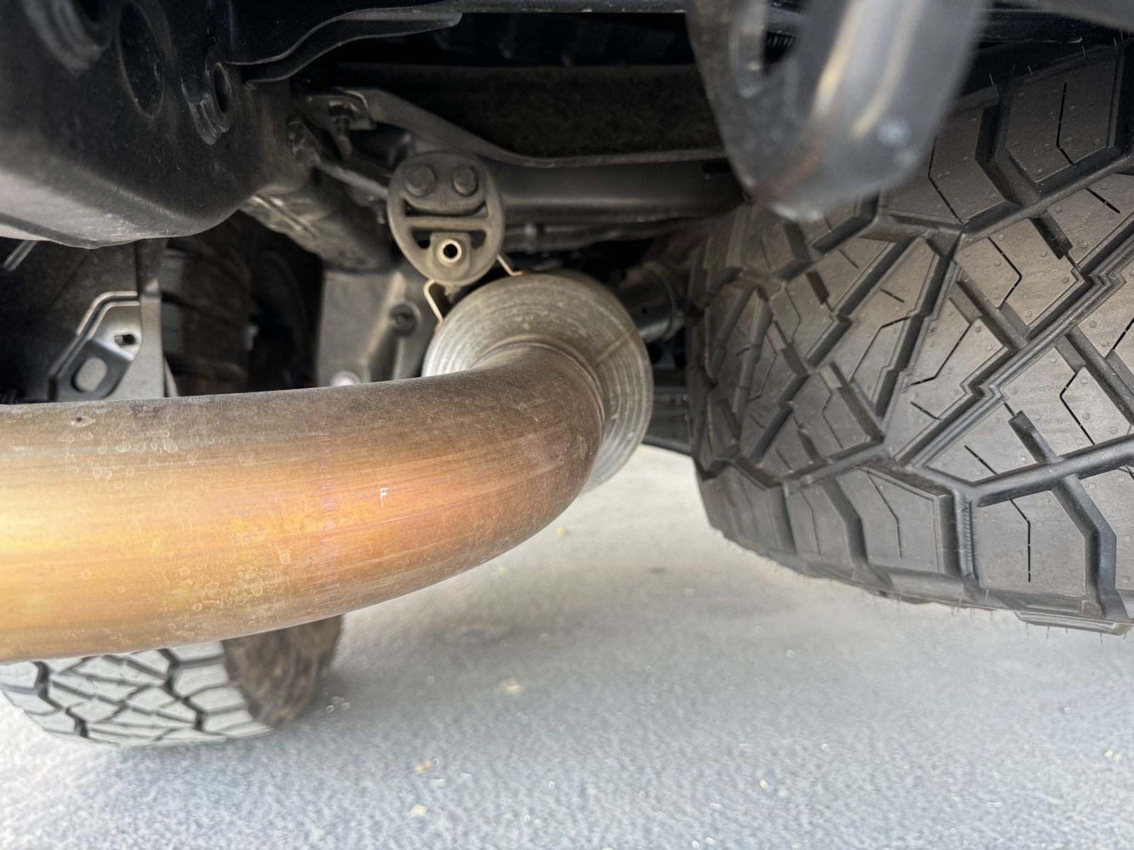

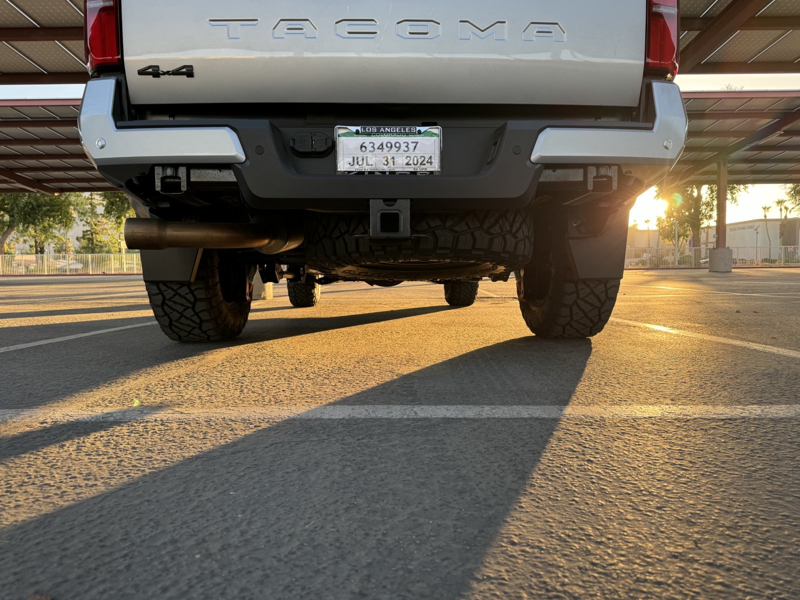

    Hard to tell from the photos, but: 1) how close is the nearest point of the exhaust to the tire rubber? 2) Can we get some actual ground clearance measurements from the lowest point of the tire?

    I measured it at approx 10.5 inches from the pavement at the lowest point. With the new 33 inch tires the diff sits at about 10 inches above the pavement, so the tire sits about 1/2 inch higher than the differential. You can see that the diff hangs lower than the tire in this pic. I don't think ground clearance is going to be impacted. However, departure angle might be.IMG_1109.jpg IMG_1096.jpg

    OK, the ground clearance is better than it looks. I can't imagine that close proximity of the exhaust is good for the tire.

    I have already ordered the OEM axle dump exhaust but it is back ordered. I am sure that will improve the situation
