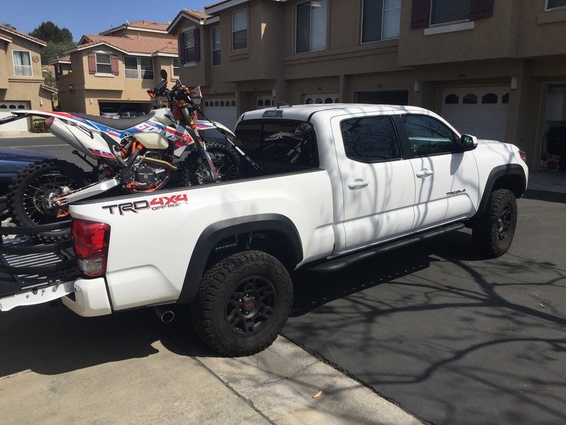

    Can't believe they didn't put a tie down rail behind the cab?? I have a roll up cover using some space along the sides and want a rail behind the cab to help carry my mountain bike. Does anyone know if such a thing exists and where I can find one? I've searched on this site but came up empty handed??? I'm sure they make them some where??
    Thanks for any help-it's aggravating!!

    Been covered many times. Reuse your hardware..
    Here....

    The 2nd gen rail fits, has been retrofitted by many here.
    So you can buy one at the dealer, look at junk yards, post in WTB here for someone parting out, etc etc.

    I love cool stuff. CCR Sport Just released a new motorcycle tie down bar that looks factory on the Tacoma. To make it fit factory, add a 57" piece of 1.25" x .25" under it and replace the stock Toyota torx screws with 6 x 40mm stainless buttonhead allens. Even the tie downs are trick.
    For tying down bikes or motos I think it's the best way:
    http://ccrsport.com/protrack-motorcycle-transport-kit-mid-size/
