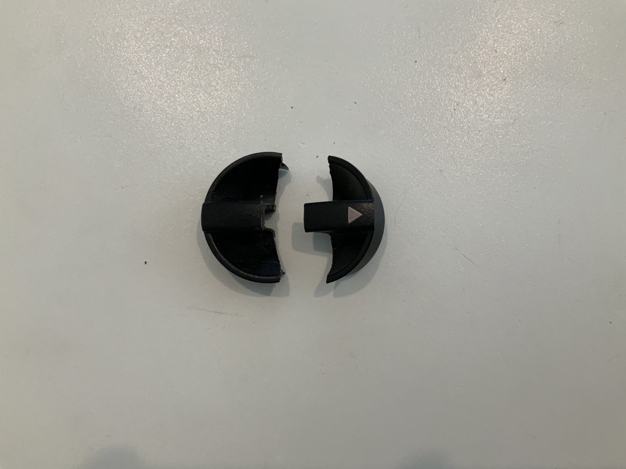

    The knob that operates the blower for the a/c and heater on my 11 year old 2009 Taco cracked and broke (pictured below). I tried super glue but it breaks when I reinsert it. Anyone know where I can find this part? Dealership?

    You could always try the local salvage yards. The part wears well, so you can find them in good used condition, dirt cheap.
    Googling "Tacoma climate knob" will surely get you a good result.

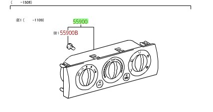

    You don't want one from a dealer unless you want the whole control assembly.

    When I had a tundra my ac knob broke. It was $6 from the dealership. I am sure taco knobs are sold alone as well.

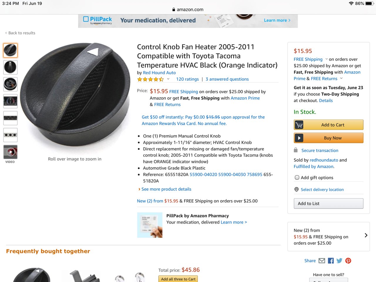

    I did the same. I have no light bleed around the edges like some of the reviews had claimed. I did add a sheet of plastic film to the stem before pushing the knobs on, though. two of them were a little wiggly without it and I couldn't get the OEM metal clips into the aftermarket knobs. After doing that they are tight with zero slop or wiggle and have a more premium feel than the OEM knobs.

    I don’t think mine have light bleed but tbh if they do I don’t mind. They are a tiny bit loose when turning but nothing I bat an eye at for a $10 cosmetic mod

    Ya all are amazing, thank you for the information. Think I’ll just go ahead and replace all 3 knobs.

    X2 on this mod. I did this on my old taco too. I also painted the back of the knob with a transparent paint to match the orangish back lighting of all the dash lights.
