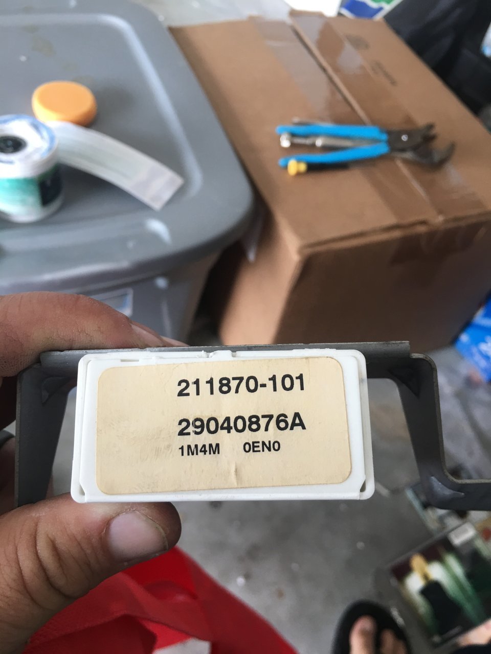

    Does anyone know where I can pickup a receiver door control # 211870-101 from? Any dealers you would recommend or sites? It is for 06 dbl cab. I believe mine went out because none of my key fobs do not work. And I just replaced the batteries. I will add picture to show what I am looking for.

    I just bought this on eBay:
    https://www.ebay.com/itm/TACOMA-200...e=STRK:MEBIDX:IT&_trksid=p2060353.m1438.l2649
    Not yet sure if it is the right thing, but... It seems like some people also refer to this as part # 89741-04010
    In fact, I lucked out and saw your post, otherwise I'd have never searched for it as part 211870-101, which is what led me to this $40 on eBay. Then again, still not sure if it is what I need.

    It did, actually! Just bought that + 2 cheap fobs from eBay for $16 and configured it using this video: https://www.youtube.com/watch?v=3qt8iJ8tDD8
    Only thing is that my truck doesn't have the "beep" when you lock/unlock, for that you need another part, which I just ordered yesterday: https://toyotaparts.lagrangetoyota.com/oem-parts/toyota-warning-buzzer-89747ac010
    So pretty much $40 for the module, $29 (shipped) for the beeper, and $16 for 2 fobs; total $85 bucks and not ever having to deal with a dealership. The beeper is also not necessary at all if you want to skip that.

    Under the hood, right in between the battery and the headlight in mine (2014 pre runner 4 cylinder), and there’s actually a little plug that is kind of just hanging out right there (they seem to have it tied up onto another cable). I’m 99% positive that’s it, so I do think it is pre-wired.
    So far it has been pre-wired for everything I’ve done to it (cruise control, steering wheel controls, door control module (keyless entry], intermittent wipers, and back up camera) with the only exception being the fog lights, which I had to work for, haha. So I’m pretty hopeful that is it based on some pictures I saw here, but can let you know soon.

    I now have located the door look receiver. Remover the glove box door, remove the glove box black trim (one 10 mm bolt at latch assy). The receiver is located above the glove box opening on the back side of the dash.
