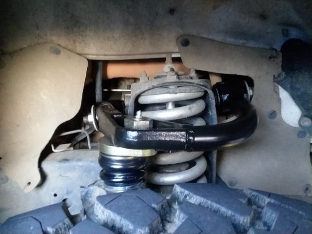

    3" coil lift spacer in front. 2" block spacers in rear. 6lug to 5 lug adapters. 20" tundra rims with 33" mt tires
    https://youtu.be/j2aIL13H0Zg
    This is a newer tacoma but the diff mounts seem to be the same as mine.i could do the spacers to bring the angle back down some

    No spacer is going to help your truck. You just keep tossing spacers on that thing. Do it the right way and get a proper drop bracket kit. End of thread. Mic drop :facepalm::bananadead:

    With angle like that the moment you let the front go full drop when off roading things will break.

    Is that bilstien shock set to lowest setting? Why would you put a spacer on top of a adjustable shock.

    The block only looks like it’s a 2” leveling kit. I don’t think there’s anyway their on the lowest setting

    Thats what im thinking. This is my eibach spring with the bilstien shock set to 0

    I have a 2” leveling kit on my stock struts for a while and my UBJ it basically even with my coilbucket, no poctires though cause I’m ashamed of my hockey pucks...

    I put the spacer on before i was aware the billy was adjustable lol. And no it has 2 more nothes to raise it i beleive. Im thi king of removi g the spacer now but if i put the billy shock to its highest setting wouldnt it put me back in the same spot with the cv axle and everything else?

    Pull the spacer and put the Billy’s at the middle setting.

    Either set the shock to the lowest setting and keep the spacer or remove the spacer and adjust the shock to the highest setting you probably have way to much lift.

    I think ill just put the billys to the lowest setting and keep the spacer on to make things easy and a softer ride on the coils.. then add the diff drop spacers to bring the cv axles down more. aaaaaaannnnd dennnnn(asian lady voice)...save for a drop bracket kit for the near future..also if anyone is interested in these 20" tundra rims or the 5 lug adapters.please by all means let me know.
