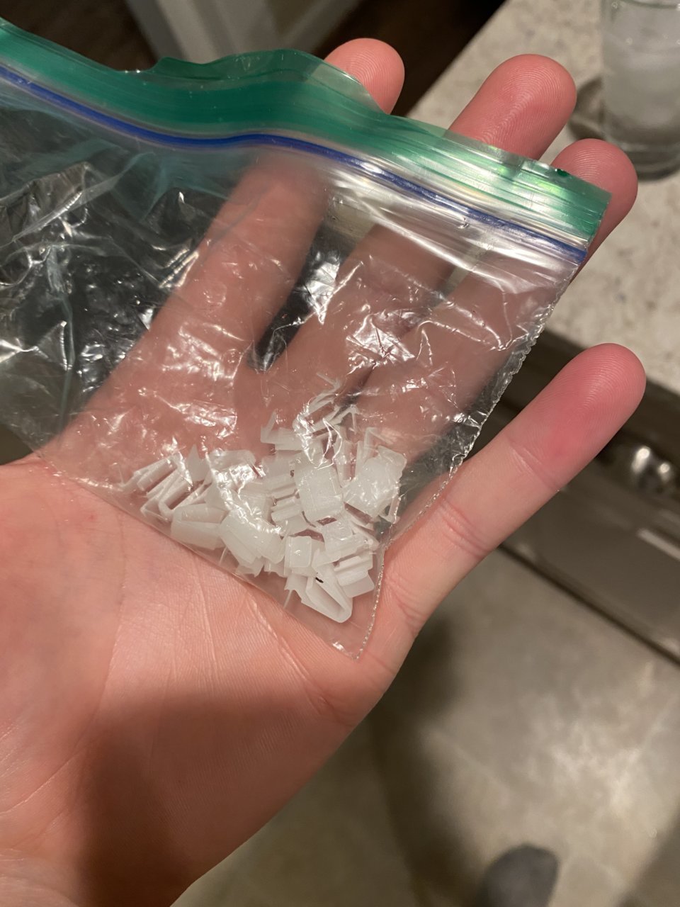

    For those that requested clips from me, they got dropped in the mailbox today. Should get picked up tomorrow.
    fake4x4 and Breeze900rr[OP] like this.

    Anyone have any extras lying around? I too am an apparent moron! All 3 into the door.

    I can drop a few in an envelope and send it your way in the morning

    if you still have a few extra i could use 3 please

    I tried fishing the clips out and just had enough, with my skills it isn't going to happen for me.
    Is there anyone interested in selling me three clips from the pack of 30? I would appreciate it very much.

    pm me your address and i can get some to you when i get a chance to buy some stamps
