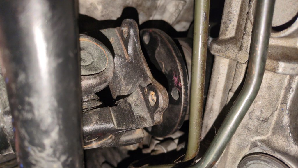

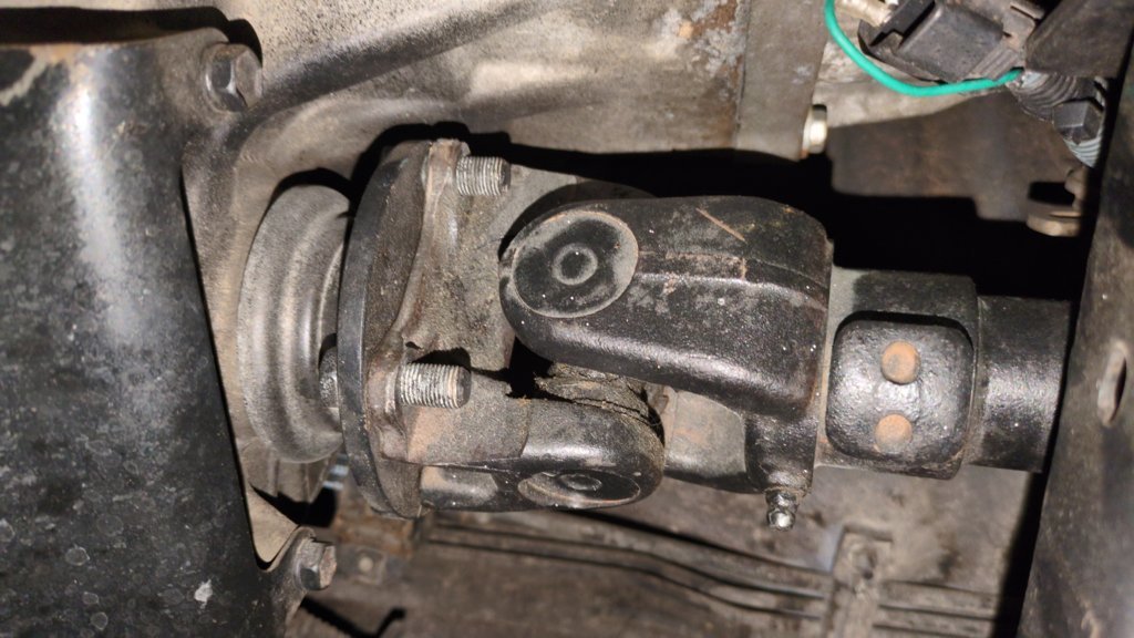

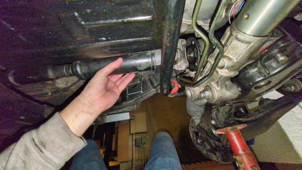

    None of the 4 sides have a slip yoke right? Do I need to order a spacer?
    What part did I get wrong?
  2. Jan 15, 2025 at 5:55 PM
    ZColorado
    ZColorado Well-Known Member
    Nov 6, 2020
    #345998
    1,154
    Near Boulder Colorado
    13 DCSB OR 6MT
    35's,Kings, NWF, 488, Harrop, SPC, Archive, Method, RCI, C4
    The shaft has a slip fitting, it's compressed. You need to extend it.

    I was just looking for the delete button after I saw this lol.. .

    This. The spot where the large tube meets the small tube will slide. Grease it up and stretch it out, don't forget to grease the rear.

    and your u-joints
