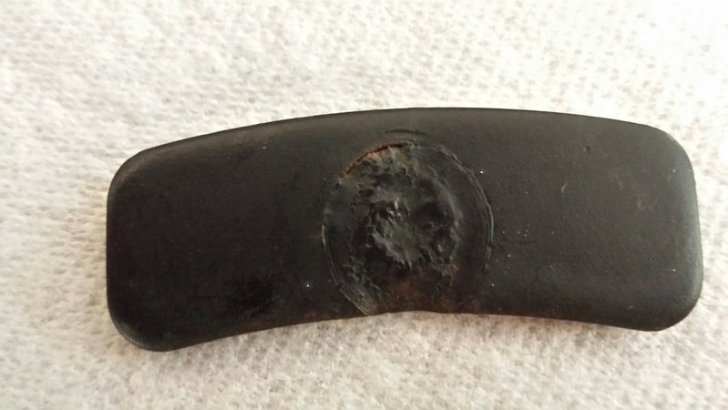

    Found this on the garage floor. Checked my drive shafts and doesn't look like it fell
    off one of those. It's 2 1/8 inches long x 3/4 inch wide with a single spot weld in the middle.
    Any ideas appreciated.

    Oooooh that's your middle chuck hitch..not good.

    Brake pad J/k Cant say that I have ever seen a piece like that.
    Weld doesnt look like it broke off, maybe a its scrap from the factory.

    Should have posted a pic of the back. You can see where a little rust got under the piece and popped the spot weld.

    It is a weight off one of your rear brake drums.

    this
    scuff it clean to bare metal and jbweld it back on, or you'll have balance issues

    Thanks guys. Appreciate the help. Off to get some JBweld.
