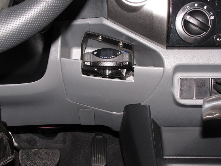

    Not a whole lot of places to mount them but here is what I didIMG_0181.jpg IMG_0183.jpg I made bracket out of aluminum then put a small block of a spongey type of material just to prevent any bounce which was minimal. This is just to the right where the change pocket was at.

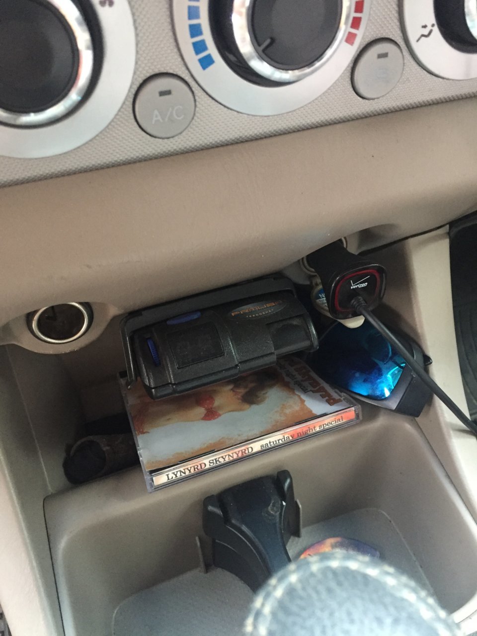

    Not the P3, but I didn’t want to drill any holes or do anything permanent. I just used high grade velcro and it’s held up a year+.

    Didn't drill any holes. Pressed a small cardboard square into the area then traced it out on aluminum. Bolted it into the area with small bolts. Cut a square hole in the back of the aluminum for the plug and it works great. I can take it out and you never know it was there

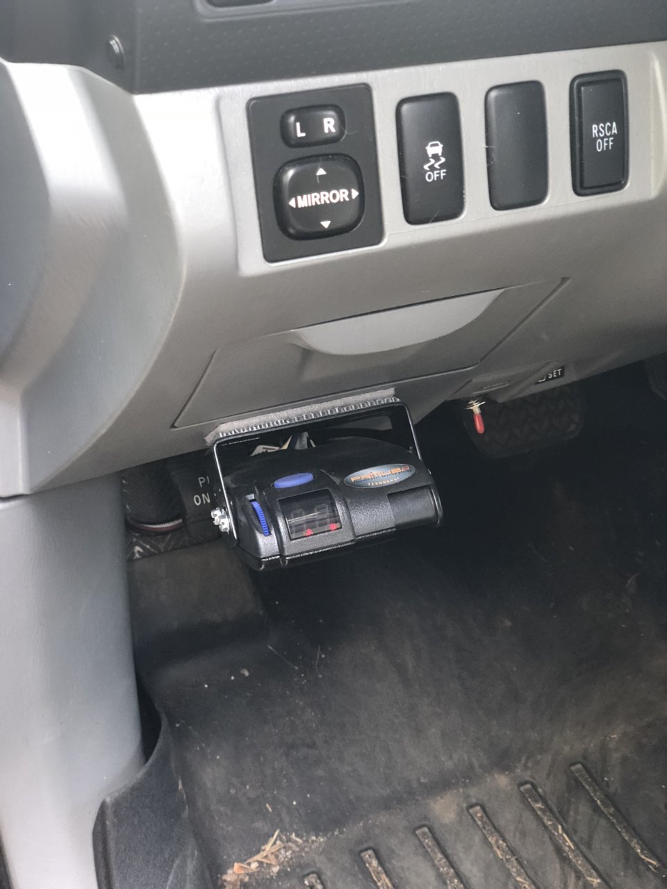

    Here is where I ended up putting mine for now. I'm use automotive velcro. I also found a trailer emulator so I could test my install without having a trailer handy. I think this may work but I am going to see how it holds on some tough roads the next few days.

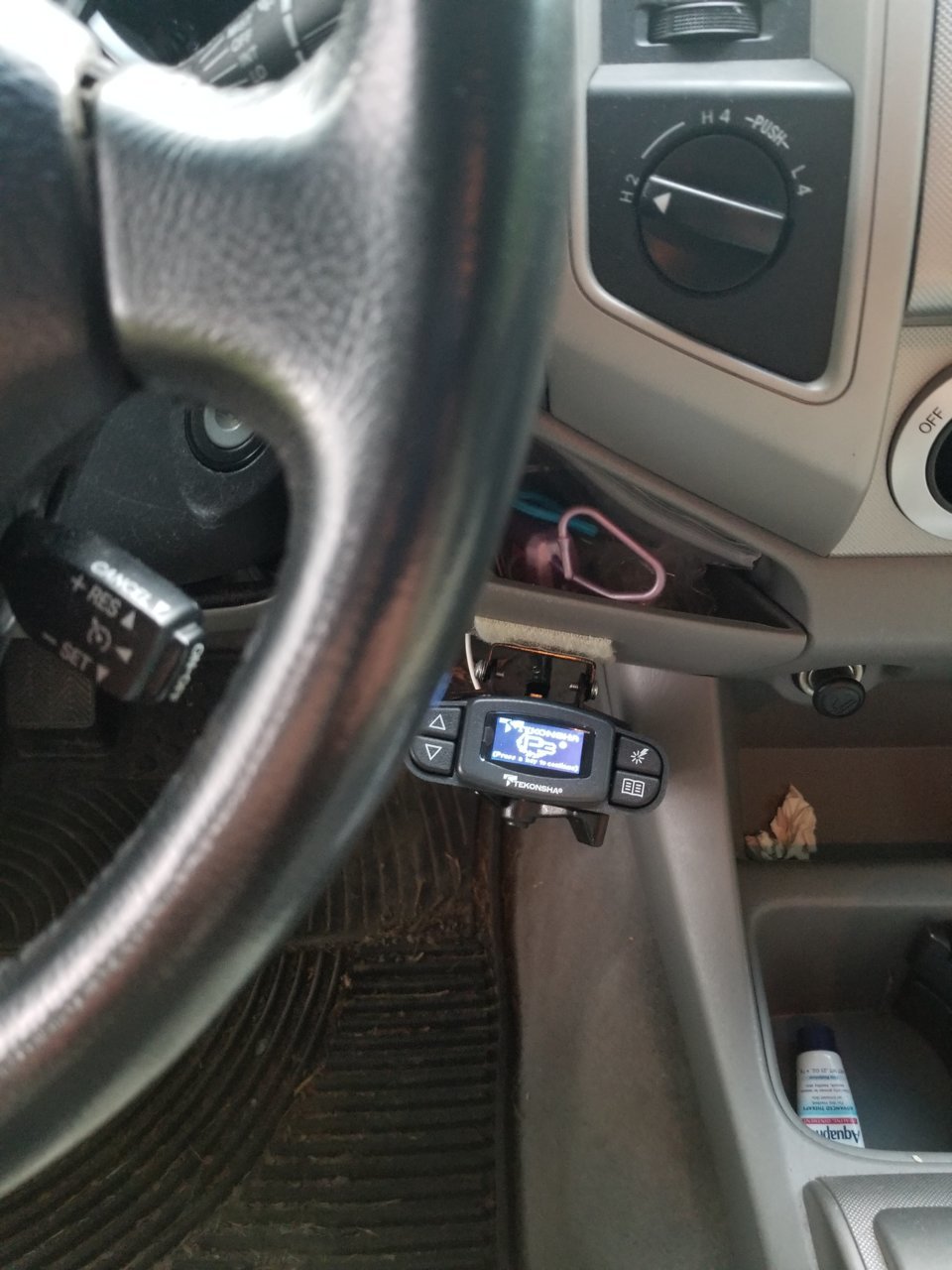

    Mine is below the E Brake handle on the Right side (Manual transmission)

    Got to use it this weekend and everything went as planned. I think it is going to stay there on the right hand side attached to the change tray

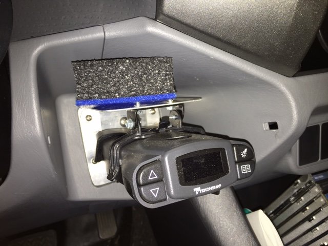

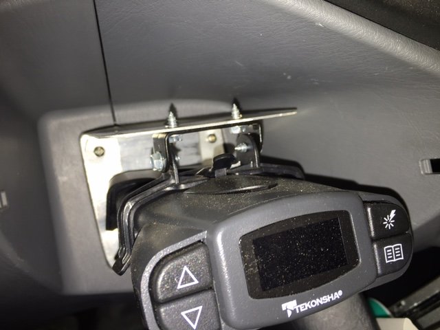

    I mounted mine (a P2) in the coin holder
    I made a bracket out of aluminum flat bar. I notched the coin holder to allow easy access to the manual brake lever on the bottom of the controller.
    I have more detailed pictures and descriptions in my build thread, page 2.
