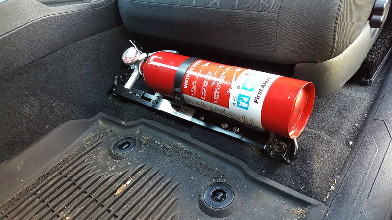

    I didnt mount mine, but behind your rear seat on the drivers side of a dc has a space that perfectly fits a fire extinguisher between the seat and the wall

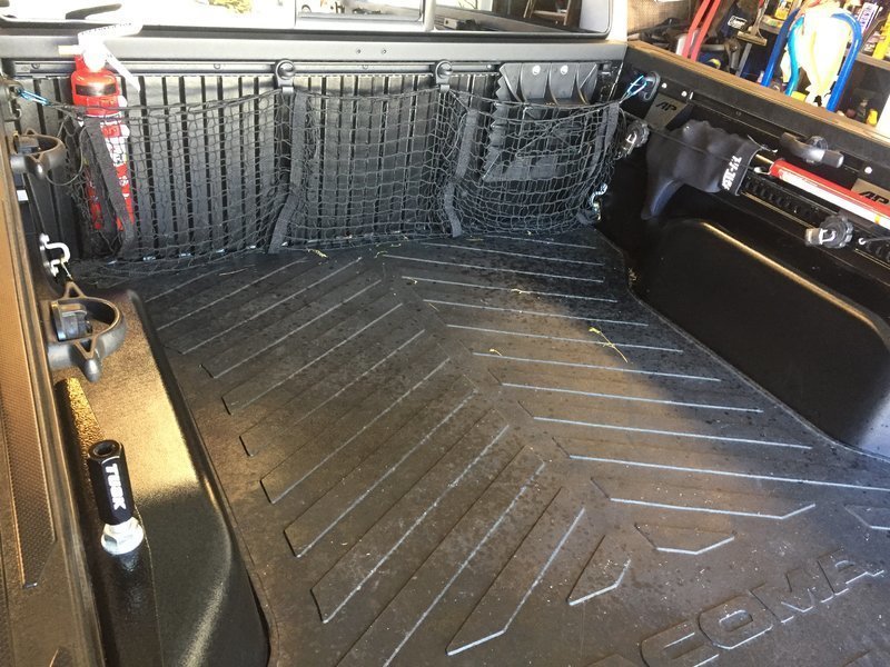

    Mounted in the bed not in the cab. I can drop the tail gate and reach it.

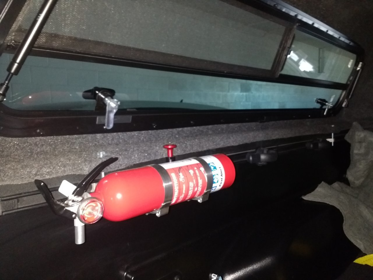

    I did some research at the UL website. To pass they test these things at something like 160-170 for a week. Also note I do not have it in the cab. It’s mounted in the bed under a rollx by the tailgate for access. The best compromise I can come up with.

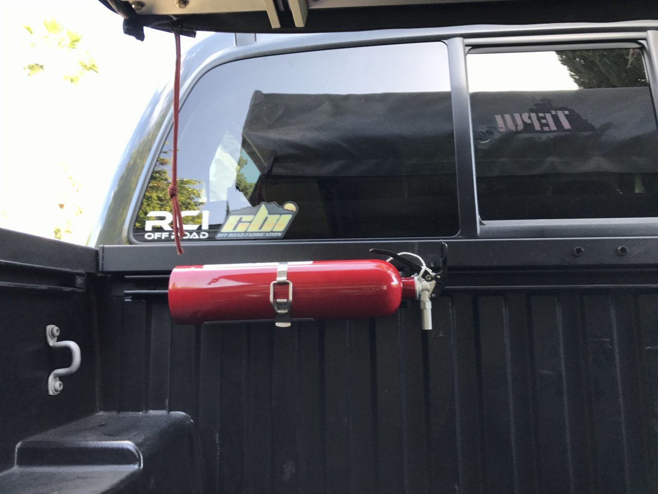

    I mounted mine on the cab bed rail (oh, I also added the cab bed rail, but that was a couple years ago). I don't keep it mounted in the elements 24/7:

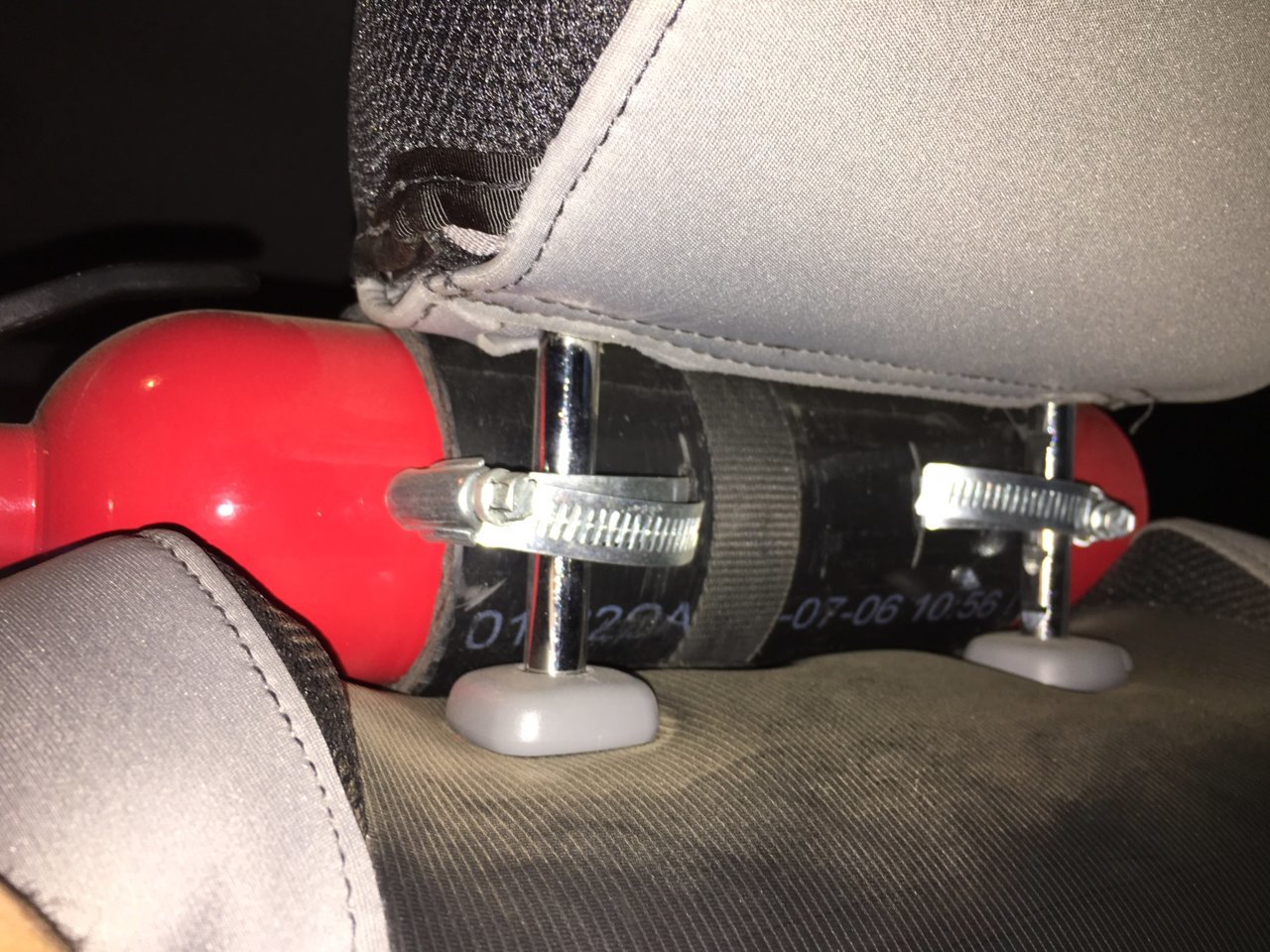

    I have one of these mounted behind my head rest in my work truck...
    https://fireextinguisherdepot.com/b...rubber-strap-brackets/amerex-bracket-864.html
    I really like the location. And since I like to save a buck I made my own with a piece of PVC sliced down the middle and some hose clamps. If all hell brakes loose you can reach with your right hand and slide it out quickly. Really easy to make/install and costs about $10. The PVC holds the extinguisher very tight, but I put a piece of webbing with a plastic clip around it to help it stay in place in case some fish tails are around the next curve. IMG_1532.jpg IMG_1534.jpg
