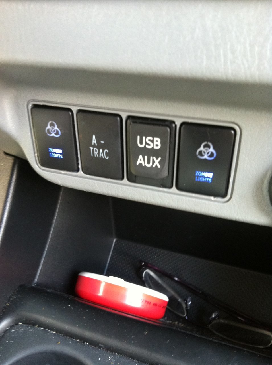

    S pod, battery, run cable to rockers through lower boot below and beside steering column
