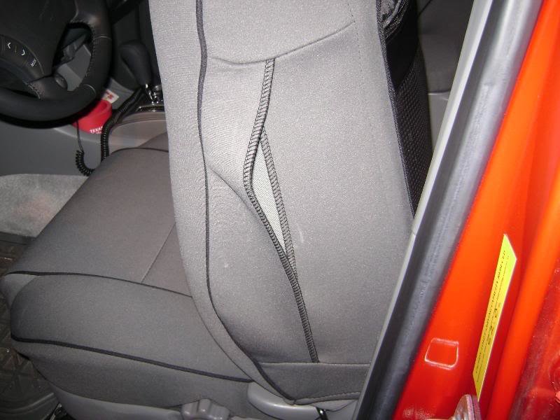

    My wet okoles have a slit on the door side of both the passenger and driver side. This allows the airbag to deploy uninhibited. If you don't have the slit in yours your airbag (assuming you have seat airbags) will fail to deploy. No bueno, I'd get a compatible set. That could end very poorly. That's a lot of energy being released that's not going to go anywhere it's designed to.

    Can u post a pic? Id like to see where the slit is exactly. Maybe i could get a seamstress to adjust it, or maybe even take it down to wet okole?
