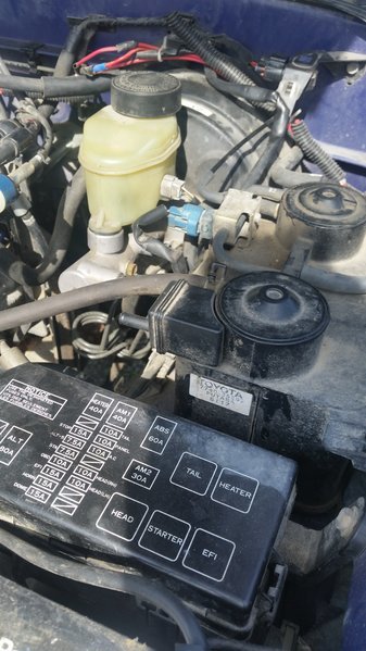

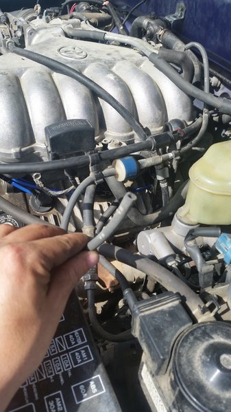

    Short and veiny of it took motor out and put back in . Got all put back in except these couple.

    this may help. on the third pic you are missing the second hose on that open nipple, right above the fuse box

    Yup. As shown in the diagram, that hose should come from your airbox.

    Nice . I hate to ask but do you have a actual picture ? I have a rubber line that runs into a hard plastic line the I'm gonna guess is what it is

    the 02+ is different. I did a google search so do that for a pic. but it looks like the hose goes from next to the "from air cleaner" down to the hard tube.

    Very nice so thats probably it . Thanks . 1 down 2 to go lol

    Ok take pictures of the hoses you don't know were they go. Also take a pic of were they come from.
  12. May 10, 2017 at 3:18 AM
    Penten
    Penten [OP] Well-Known Member
    Aug 6, 2013
    #109876
    1,186
    Peter
    Iowa

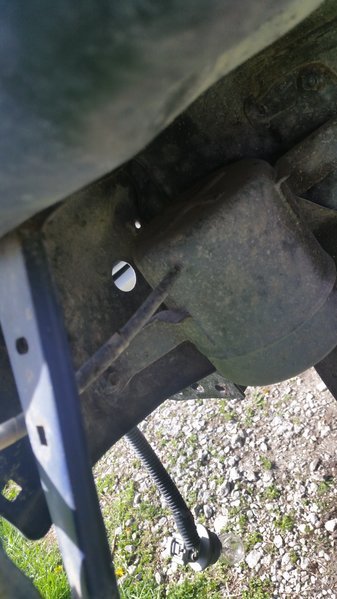

    Pictures not load? 1 comes from that black cylinder looking thing under the drivers side fender and the back of the manifold it's the one with the blue filter thing

    I see those pictures. Is that the only ones you need help with? Those are for the switching actuator or the front axle. There should be a VSV the both run to. I'll see if I can find a vacuum diagram for the front axle.
  14. May 10, 2017 at 9:34 AM
    mechanicjon
    Dec 2, 2016
    #203828
    10,149
    Jon
    Scottsdale Arizona
    See if this pdf helps
  15. May 10, 2017 at 9:44 AM
    mechanicjon
    Dec 2, 2016
    #203828
    10,149
    Jon
    Scottsdale Arizona
    Below the evap canister is were the VSV should be located.
