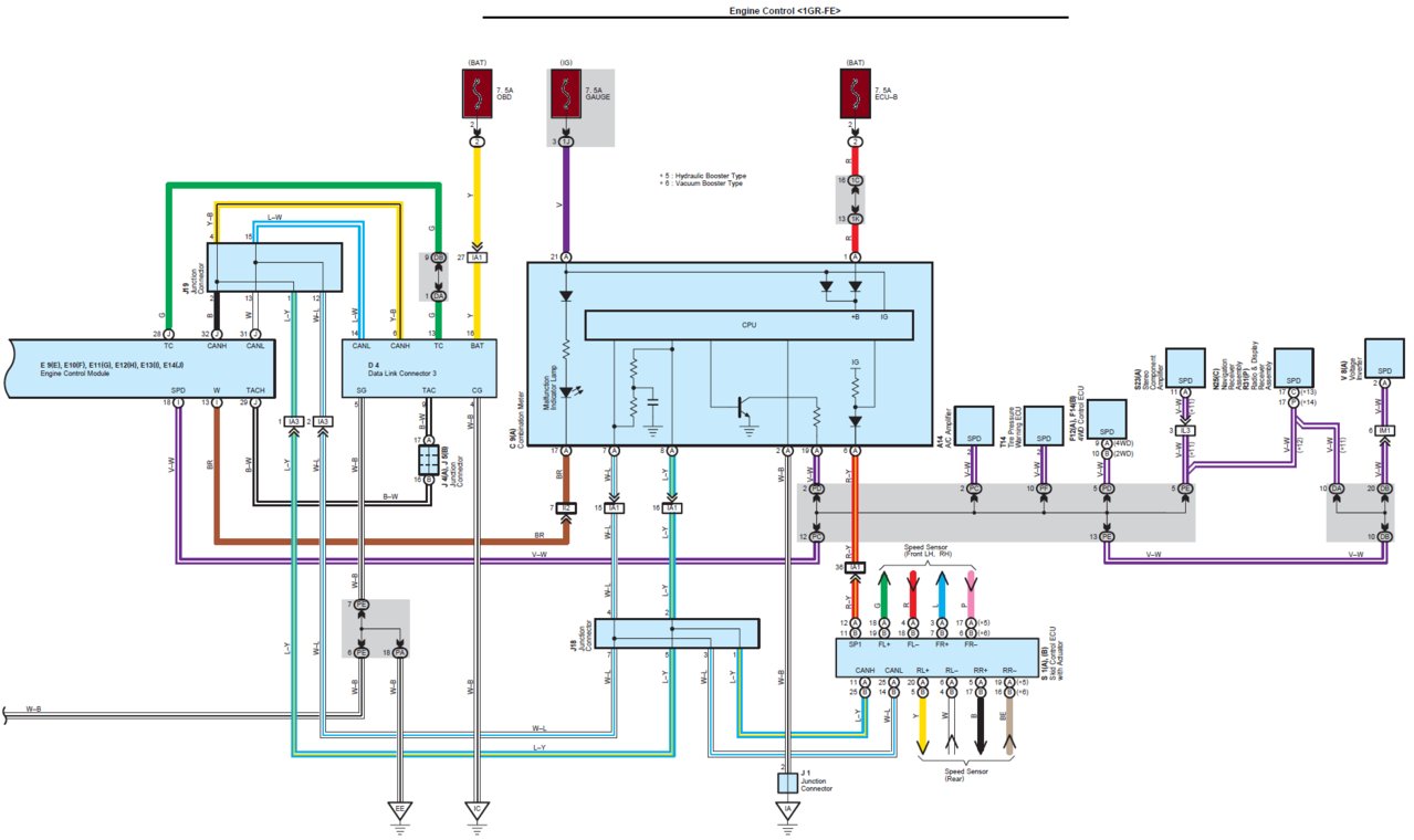

    I have a 2015 trd sport with the 4.0l and I'm trying to wire up a Digital Dakota speedometer corrector and I'm trying to figure out which wires took spice into to get wheel speed from the instrument cluster

    If you post the manual for the DD speedometer corrector that you're using, I can let you know what you need to tap into.
    The violet/white wire is the speed signal wire on Toyota's.

    Red/Yellow at C9 connector #6 spot.
